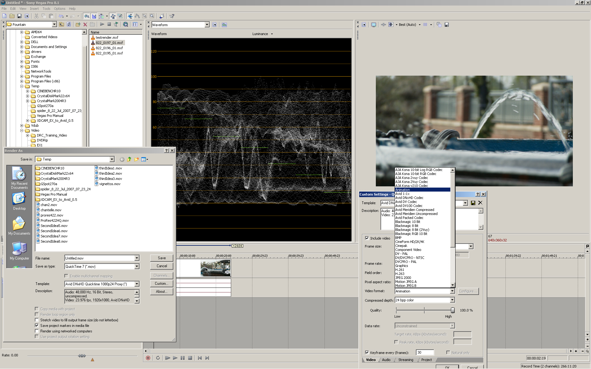

Originally Posted by Kevin Amundson View Post
Perrone, I will definitelly be taking you up on your offer about discussing my workflow. Any pointers or steps that I can take to help streamline my workflow would be greatly appreciated! I will shoot you an email through your profile with my email address.
Thank you for confirming that I can export a QuickTime movie with the animation codec out of Vegas. As stated above, I like to work in a 16 bit environment to prevent any loss of quality while adding CC, effects, etc.
Here you can see a screenshot of some of the quicktime codecs available/loaded.

Perrone, thanks for the screen grab!
