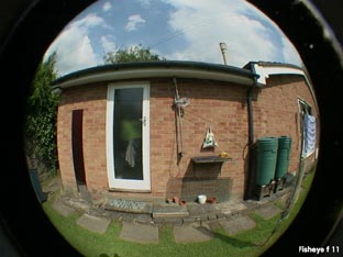

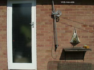

Here's two pictures of the back of my house. One is the Sony VX2k on full wideangle, the other - shot from the same position - is shot through a single-element taken out of an old wide-angle lens I had lying about.
tom.
