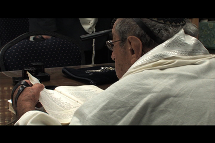

Hi, try the "A" setting, not the dimbulb green-box full-auto setting, and good luck! I'm trying herewith to upload two frame grabs which might be illustrative --- the original hdv capture frame and the ntsc (720x480) result from Final Cut exporting sd from hdv....I have not had good fortune attaching largish files, even though they are smaller than the allowable size, so apologies in advance if it doesn't work....but I wanted to illustrate what I see when I shoot HDV....here goes... / bvaughan
General HD question related to XHA1.-hdv.jpg   General HD question related to XHA1.-ntsc.jpg

Also, your frame grabs are fine, naturally, the SD one is a quarter the size of the original, so it's hard to compare them. I undertand what you're getting at, though.

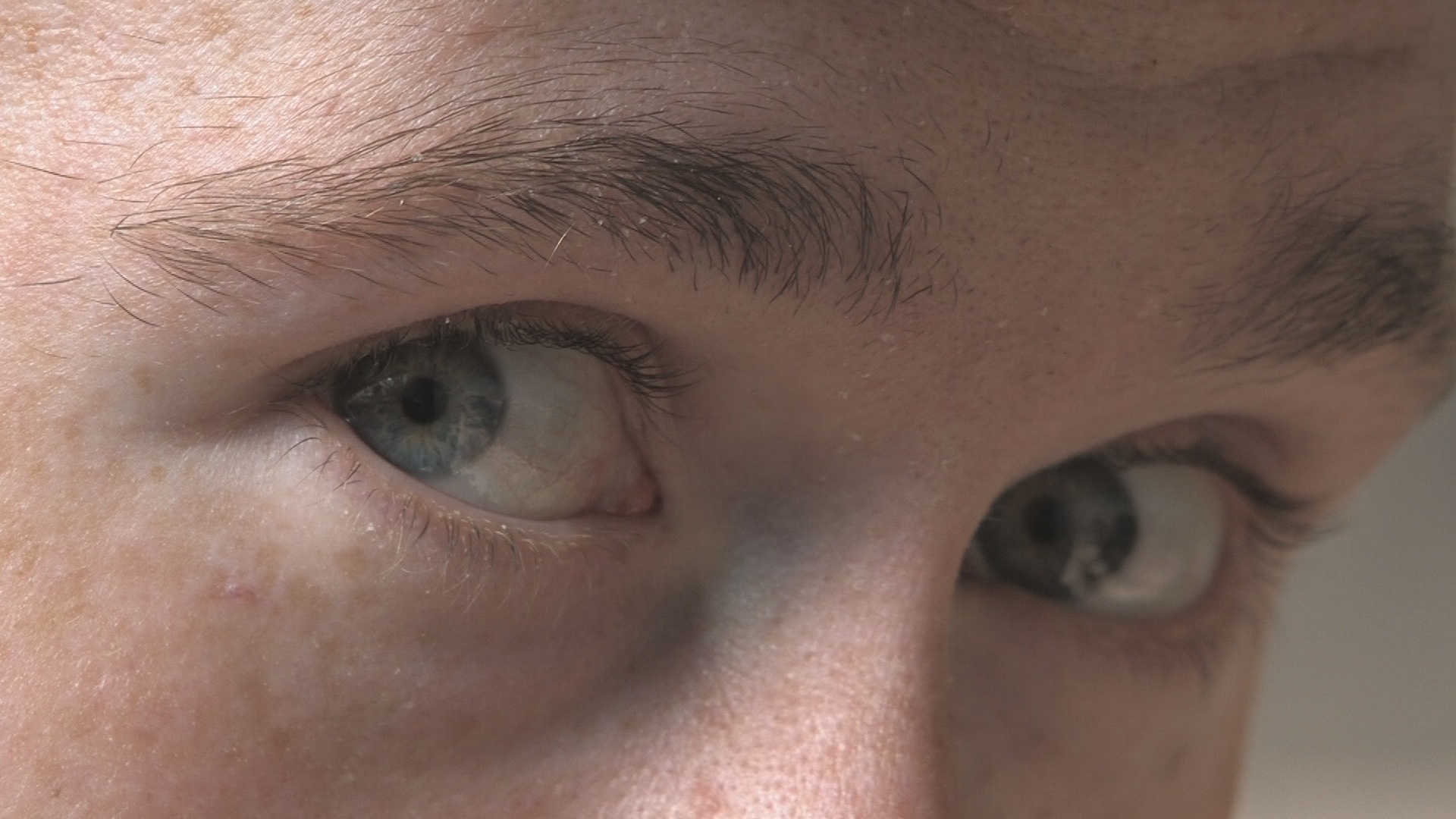

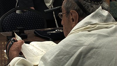

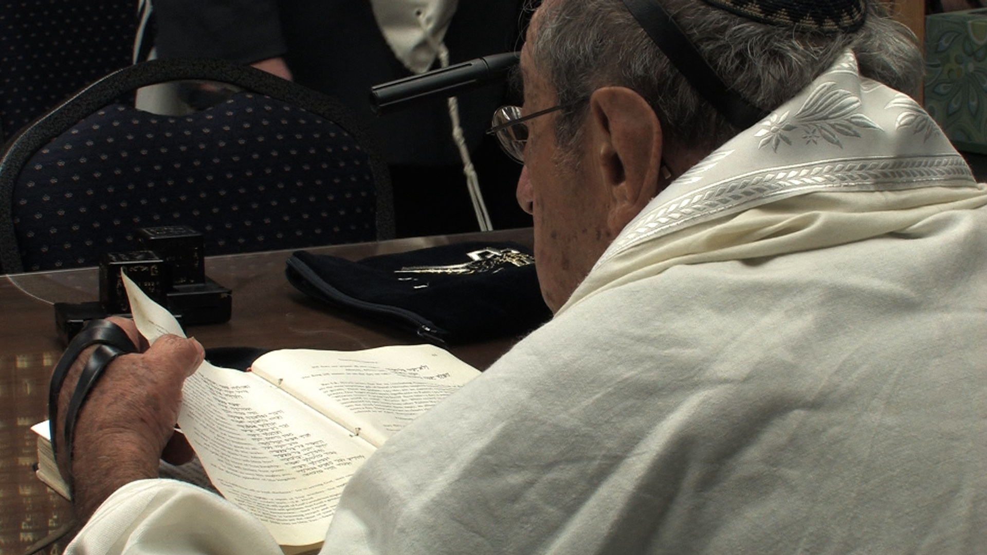

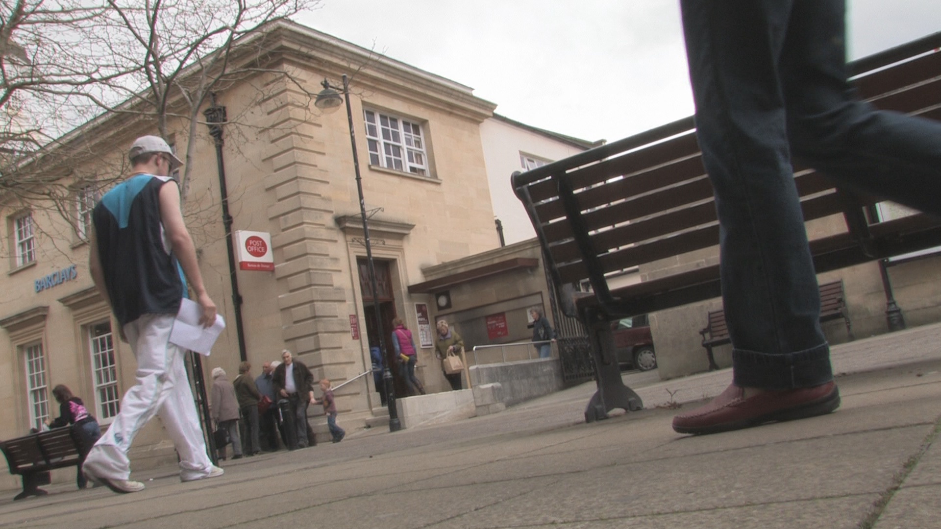

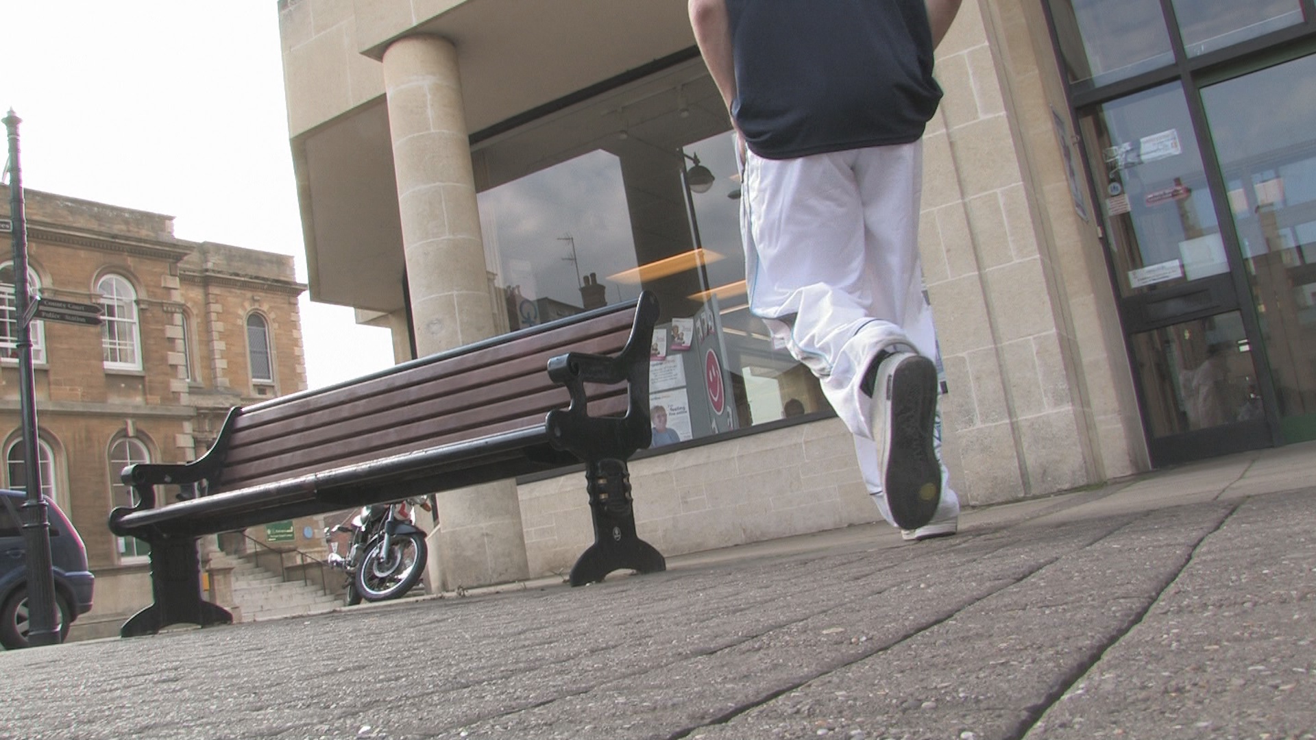

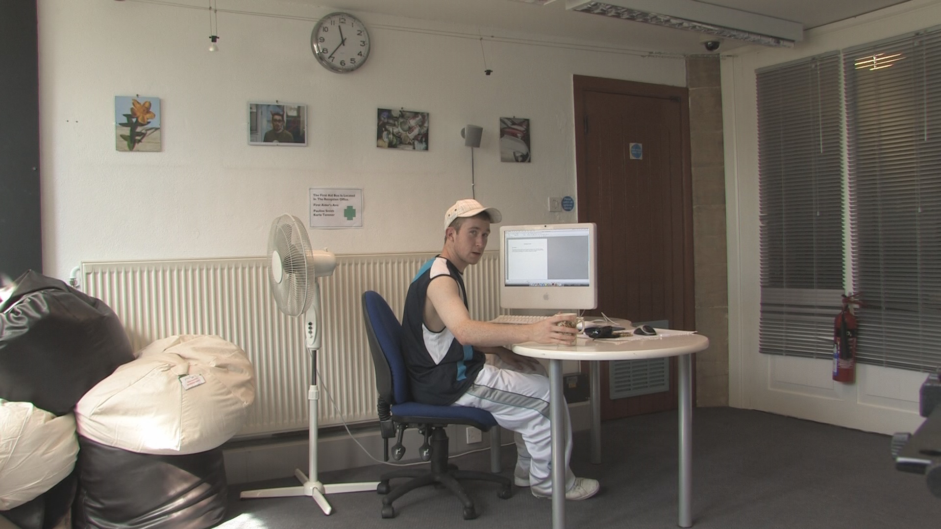

Screens
Here are some screens.
Image 0 is auto (the 'A', not the green box).
Images 1, 2 & 3 are manual with auto focus, HDV, 25P, 250 shutter, no AGC, -3dB, Panalook preset.
There is no postproduction.
Once you've clicked on an image, you can click again to see it full-size.

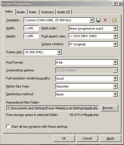

ScreenHunter_01 Apr. 07 10.37.jpg is the Vegas project settings.
Like I said, it could just be shoddy workmanship, so feel to let me have it!
Ta,
NR.
PS - forgive the chavvie costume. He's playing a chav.
General HD question related to XHA1.-image0.jpg   General HD question related to XHA1.-image1.jpg
General HD question related to XHA1.-image2.jpg   General HD question related to XHA1.-image3.jpg

Old April 7th, 2009, 04:53 AM   #14
Location: Yeovil, Somerset
Posts: 16

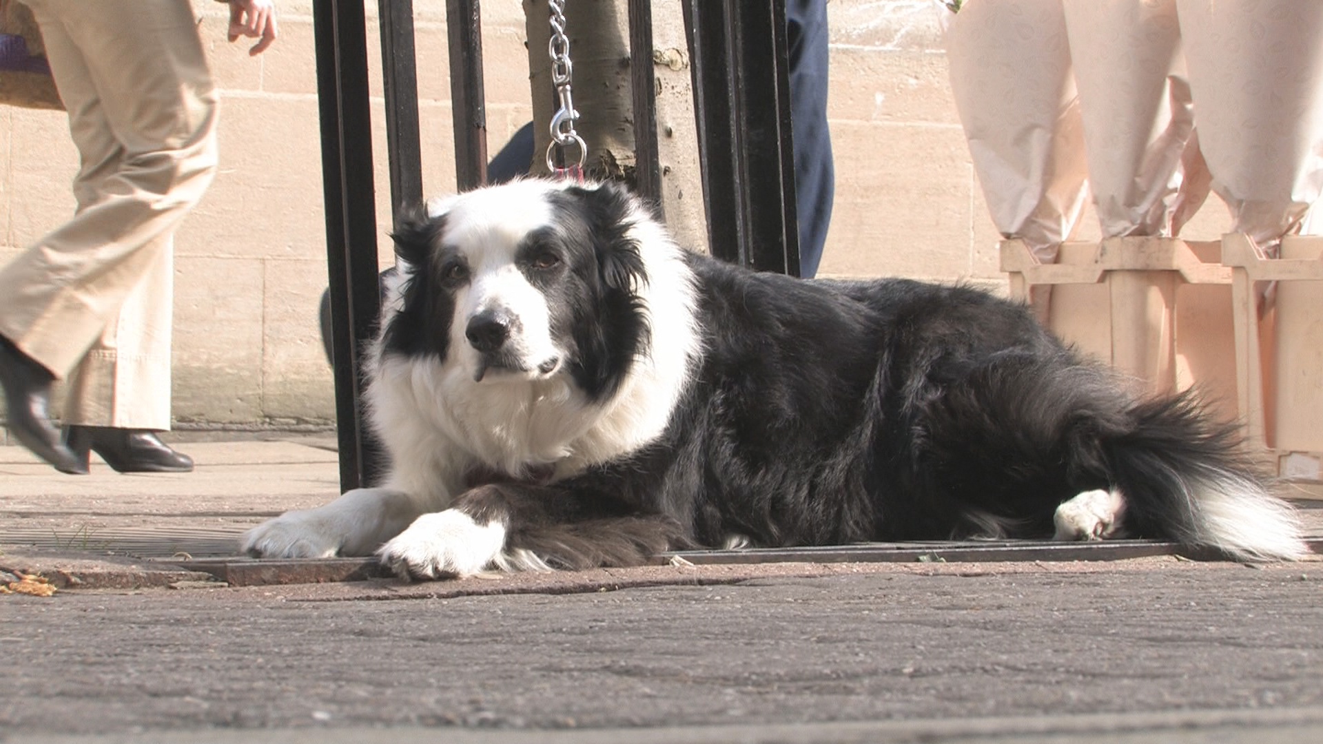

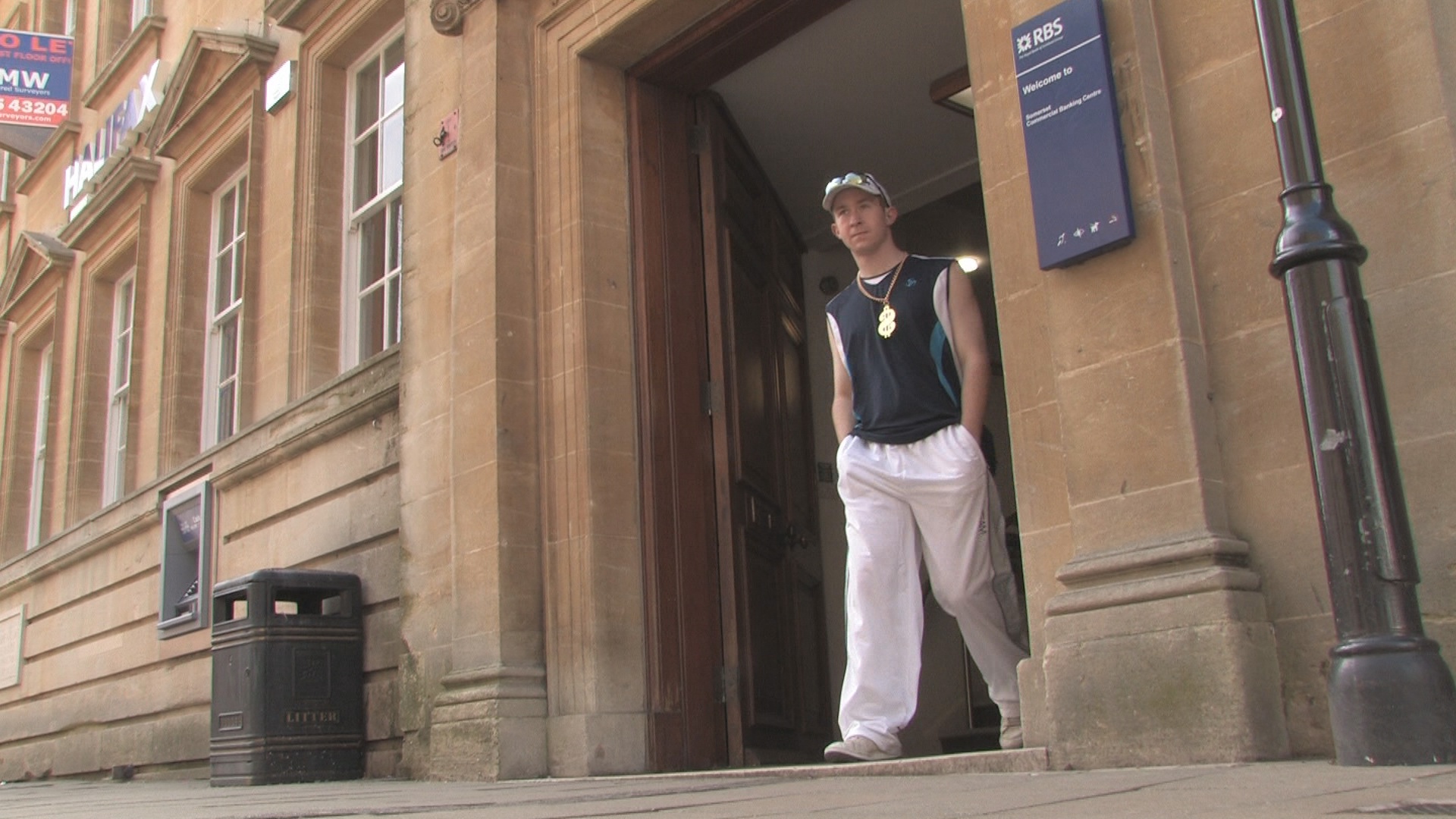

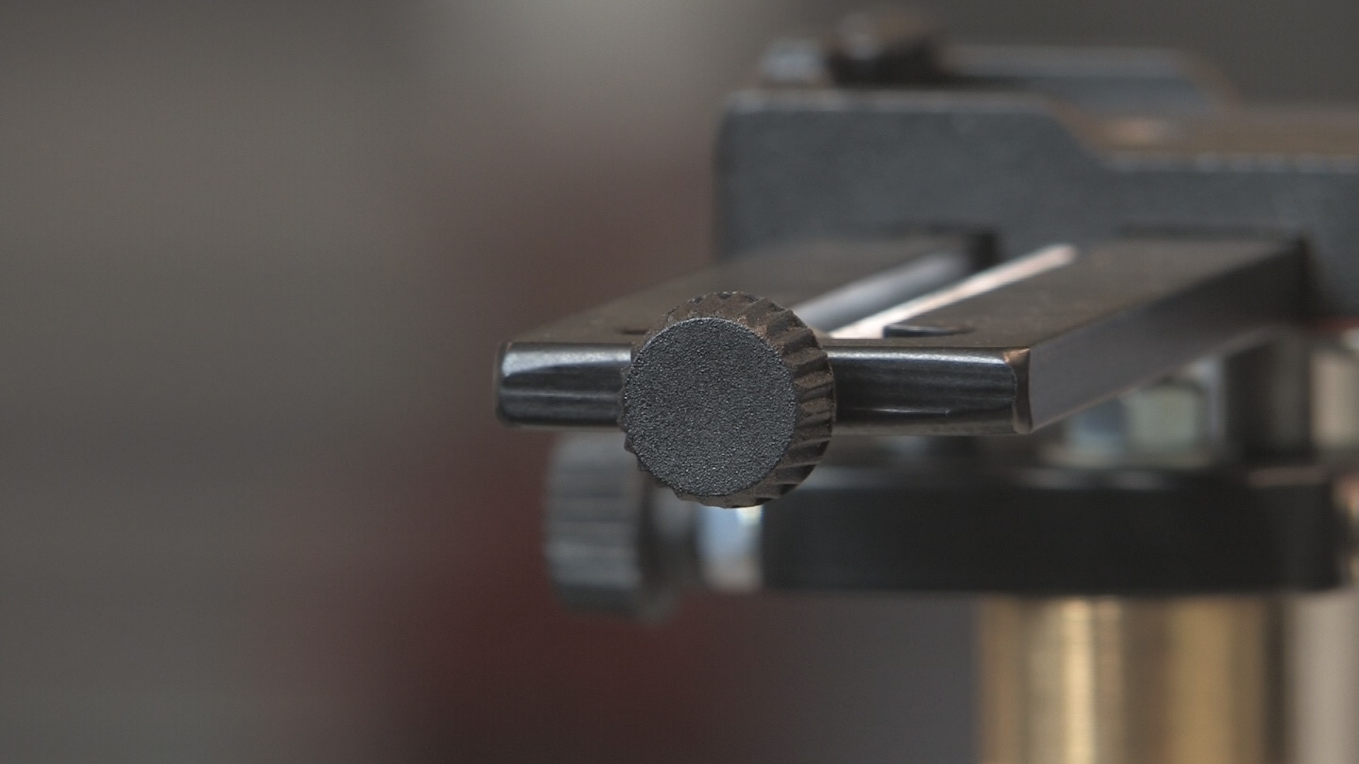

More grabs.
Here are some grabs of footage shot on HDV, 50i, Auto, no custom presets, raw from Vegas.
General HD question related to XHA1.-image5.jpg   General HD question related to XHA1.-image6.jpg
Neil G. Randall is offline   Reply With Quote
Old April 7th, 2009, 05:05 AM   #15
Location: UK
Posts: 20
They look fine to me, but I'll leave it up to the experts to comment.
Lines look a little jaggedy, but I think that's down to the compression of the stills. What I do see are chromatic abberations, particular around highlight areas. This does make the images appear "soft" as you describe. But I think this is down the limitations of sensors around the prosumer range. This is where skilled/controlled lighting become an important element in your production.
Andy Wong is offline   Reply
