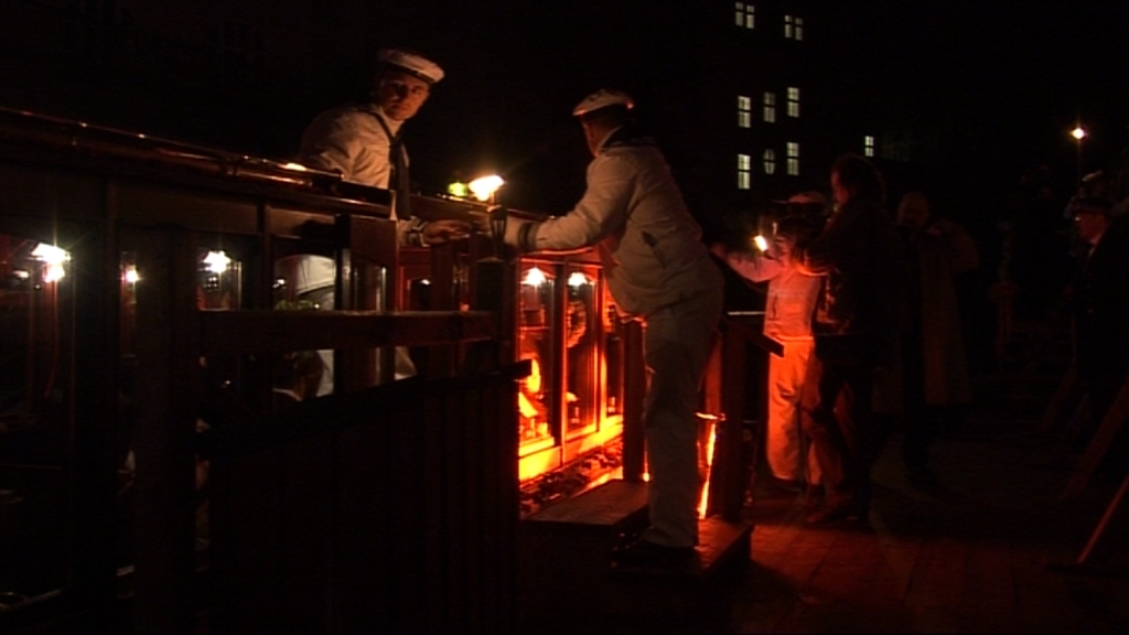

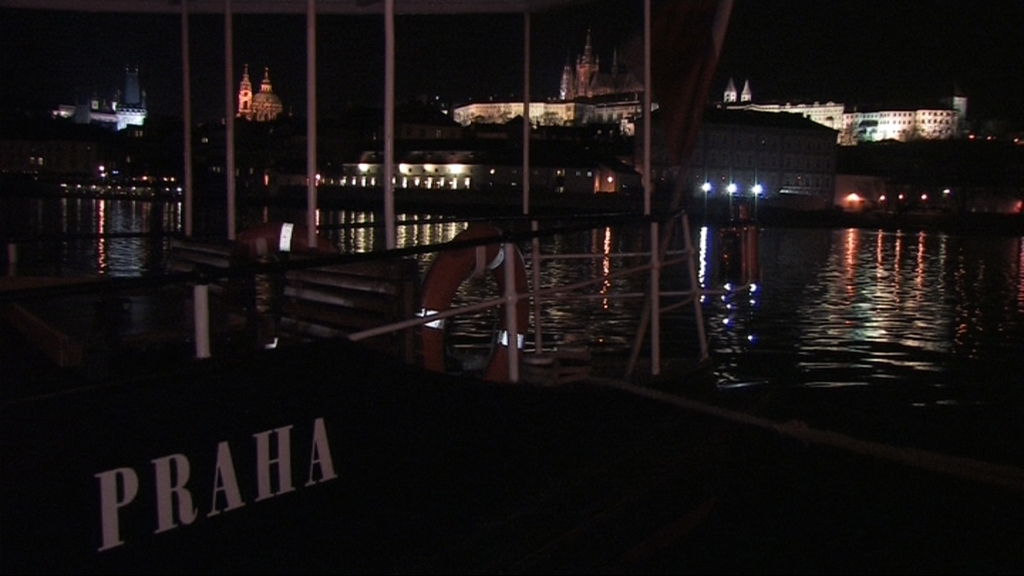

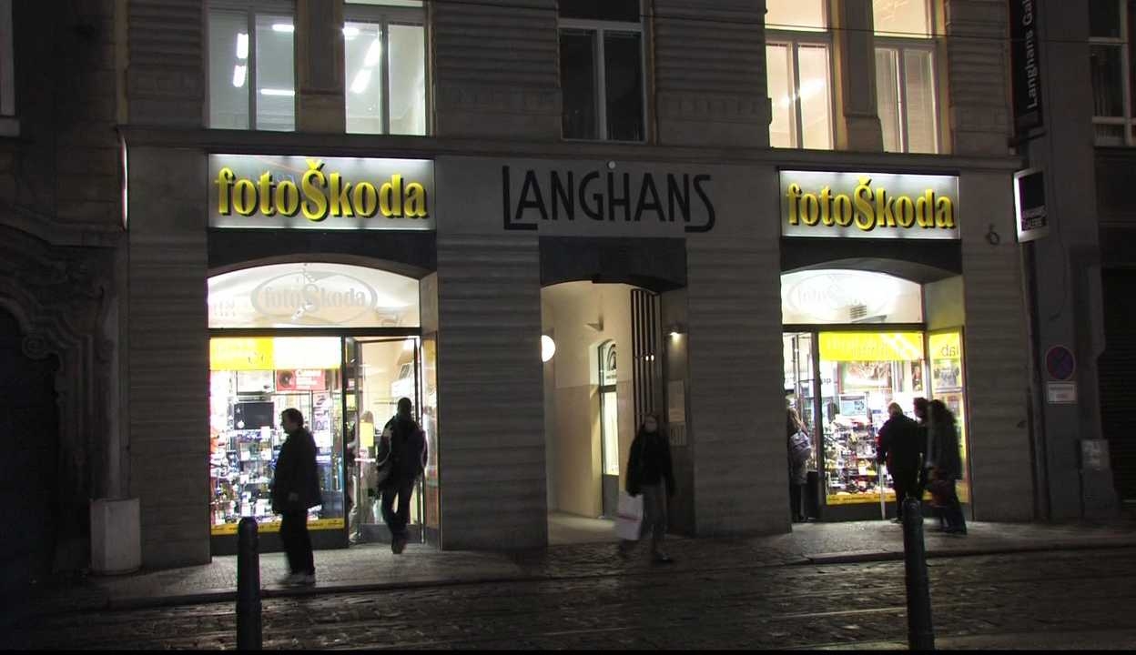

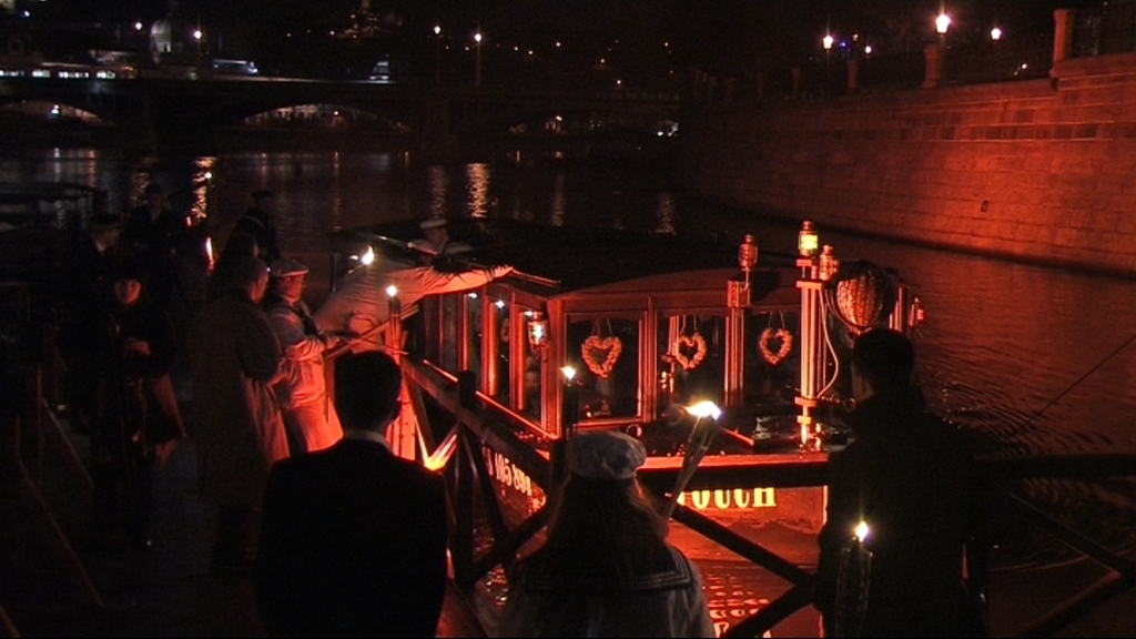

This is my pictures, XH-A1 +6dB gain and second half +12dB gain (one is from Z1)
on youtube - YouTube - XH A1 no?ní m?sto_test
Xh A1s & image noise?-xh_a1_plus12db_001.jpg   Xh A1s & image noise?-xh_a1_plus12db_0011.jpg
