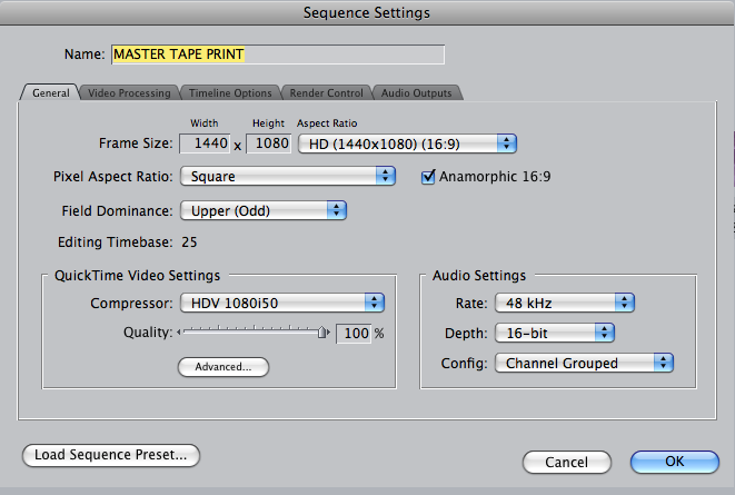

Print to Video HDV to Canon XH A1 from FCS3
Ok, got it running - I followed these instructions. They are simplified for use with XH A1 and FCS3:
1) Turn on your XH A1, with NO firewire cable connected, make sure the following is selected:
PLAYBACK STD: HDV
AV to DV:OFF
HD DOWN-CONV:OFF
2) Then connect a firewire cable between your XH A1 and your Mac
3) Start FCP
4) Go to Final Cut Pro menu, select Easy Setup, Select HDV 1080i60/i50
5) Go to A/V Settings and select the following:
Sequence - HDV 1080i60/i50
Capture - HDV
Device Control - HDV Firewire Basic
After the footage was conformed to HDV I did get preview on the Canon's LCD.
Be careful here, you must first press REC+PAUSE on the camcorder and then quickly press "OK" in FCP to begin the Print To Video process.
NOTE: The sequence setting must be set to 1440x1080. HDVi50
compressor, it will not work with HDVp25.
My last question would be should I set the sequence field order to Upper or None?
Hope this helps & thanks for tolerating my ignorance.
Pavel.

Now the good news
If you have gone all the way here with your reading I congratulate you.
Why?
Because I finally managed to print to video smoothly.
Here is the recipe:
Firstly export the entire colour graded project with effects, etc. into a self-contained movie if you work with HDV. Then load the movie file into FCP7, place onto a new sequence, affirm the settings (see attachment on the exact sequence setting).
And then happily print the movie onto the tape via firewire and with preview on XH A1 LCD.
The quality is great and because it is interlaced I imagine the content will be viewable on many decks including Sony ones.
Hope this helps any other DVInfo friend if one needs to print to video their the beloved movie project onto MiniDV in HDV format using Canon XH A1 as a deck.
