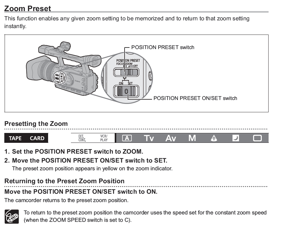

EDIT: And here's something else we all forgot - the zoom preset can be handy too. (Page 34 of the PAL user's manual)
