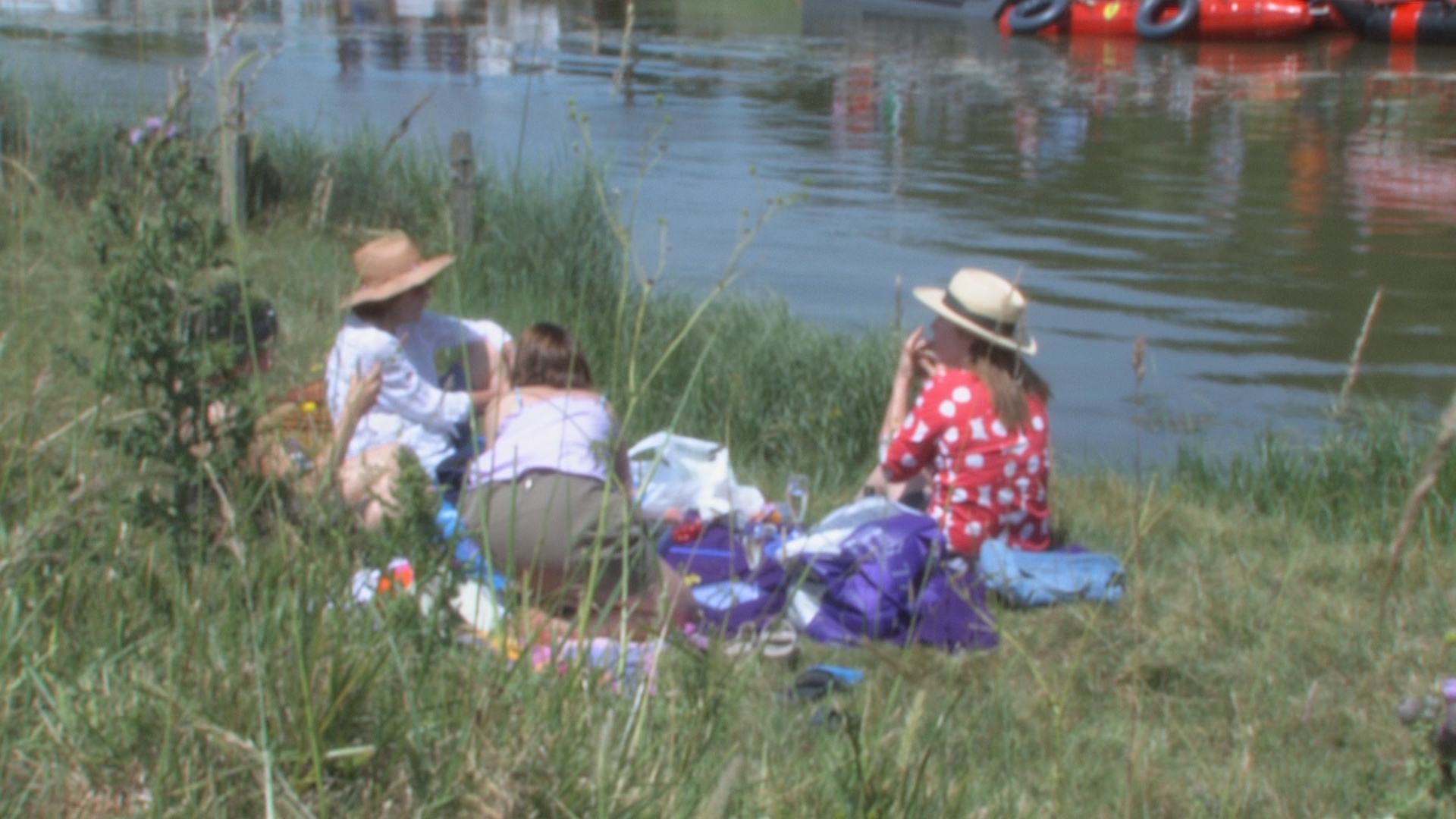

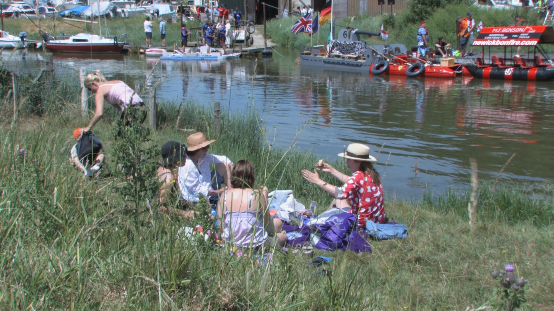

Here is an instance where I initially forgot to use the ND filter. When filming outside events I use TV mode and check the aperture setting by pressing the Exposure Lock button. If the f number is high, I use the ND filter.
David Dalton is offline   Reply With Quote
