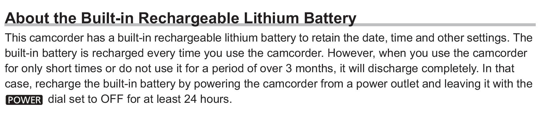

The internal lithium battery will go completely dead if the camcorder is not used for an extended time. I don't know if replacement is a do-it-yourself operation.

BJ .. when you power your A1 with your local mains AC, it overrides the internal lithium battery and the cam should instantly power up
and operate as normal.
As Mark posted .. leaving it powered off but on AC for 24hrs, fully charges that internal battery to retain your user settings.
Every time you run your cam on its supplied battery, it's also re-charging that internal battery, that's the way it's designed.
I don't think it's a problem with your internal battery, I've never heard of it and changing that battery is not a user function.
But if all else fails leave the cam on AC for 24hrs and see, you've got nothing to lose.
