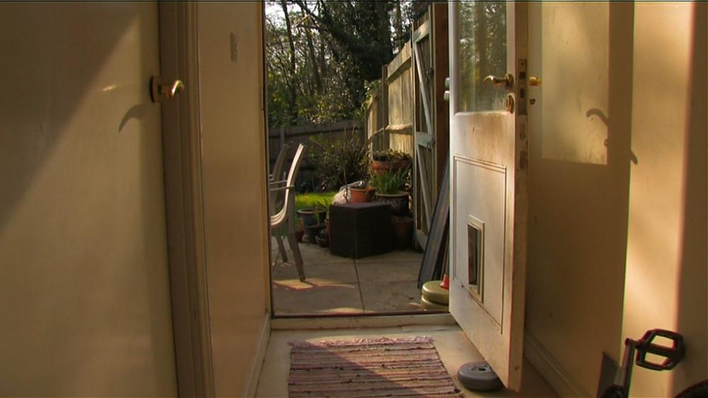

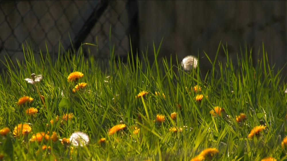

I have now tried the century optics compact hd 0.8x converter. The last wide-angle I tried was a zunow 0.7x which was terrible with 1/3 of the image soft around the edges and very bad abberations. Well I thought I would be safe with the century as it is only a 0.8x and century are said to be among the best you can buy and they are by no means cheap.
Unfortunately the edges are still soft although not as bad as the zunow at around a 1/5 of the width of the image being affected to some degree vs 1/3 on the zunow. The abberations are still there and to me are at an unacceptable level. The one good point about it is the size, it is light and is so small it does not block the instant af sensor.
Even when switched to sd the softness remains unchanged although the abberations are reduced significantly.
I have given up, and considering the cost of this wide-angle it is simply not worth the bother and in my opinion ruins the quality of the image from the stock lens which is excellent.

The entire frame looks out of focus to me in that example you just posted.

Sorry about the quality of the stills, this one is far better at showing the abberations- (Just look at the fencing, terrible)

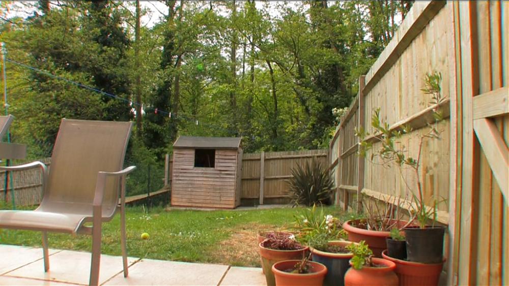

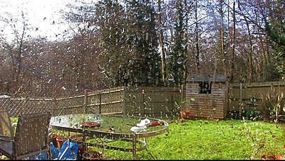

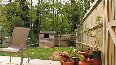

The stock lens is amazing
