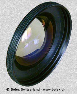

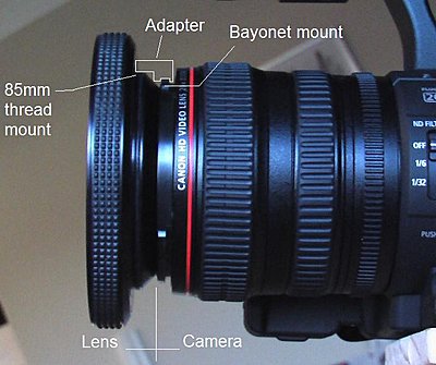

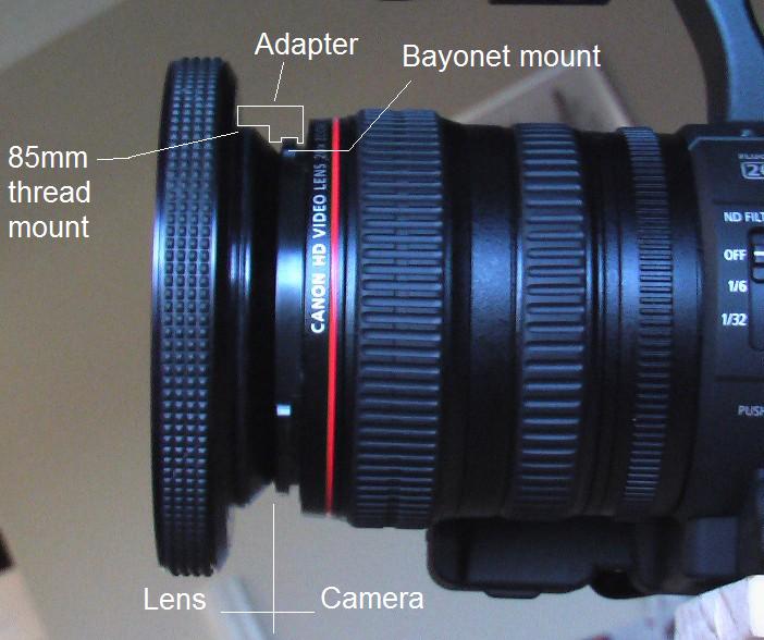

but the link doesn't work. I was thinking about getting the red eye until I saw the sample. Looked pretty average to me, lots of distortion and soft edges. If you can afford it the Aspheron is the one you want. Fairly light weight, but needs a custom step ring (attached image).
http://www.bolex.ch/NEW/?p=3
Do a search for Tom Hardwick's posts, he's tried just about every wide there is.

Thanks, Andy. I did check out those threads... and there is a lot of discussion about different adapters, but I find almost no mention of the Century WA adapter. Sure would like to see some sample pics.
Looking at the pics you posted... does the bayonet-mount fit on the XHA1 without an adapter? Is there something on the front of the lens that I haven't noticed that would allow the bayonet-mount to grab hold? (I'm at work now so I can't check.) Or is the bayonet-mount threaded on one side? (Or maybe... just maybe... it works with the lens shade bayonet mounts?)

No for the Aspheron you will need to get a custom adapter made, you can connect to either the thread or the lens hood bayonet, the picture I posted shows a bayonet adapter that I don't have. I've ordered one that attaches to the thread mount, attaching to the bayonet would hold the lens a little closer so less likely to vignette in the corners.
