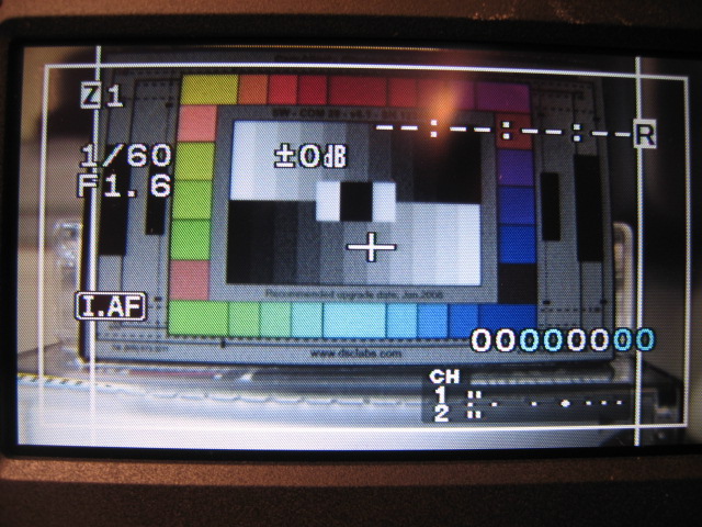

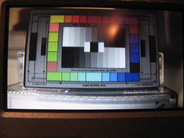

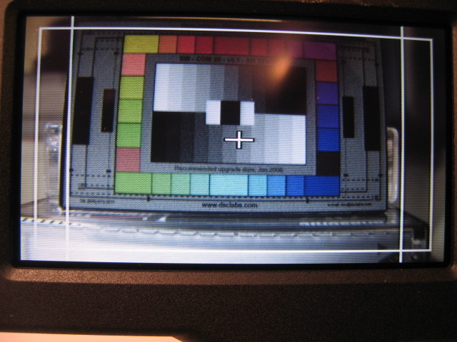

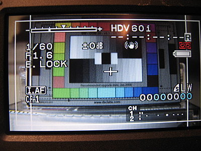

Old November 23rd, 2006, 09:23 PM   #8
Posts: 27,382
Correction: there are *four* stages that the Disp. button cycles through.
First: Everything (defined by your choices in the Display Setup menu)
Second: Only your desired info, as defined in the Custom Display menu.
Third: Guides only (markers and aspect ratios, from Display Setup menu)
Fourth: All Off
See attached pics (click each to view large) -- Hope this helps,
Changing display settings-img_6939.jpg   Changing display settings-img_6940.jpg
Changing display settings-img_6941.jpg   Changing display settings-img_6942.jpg
