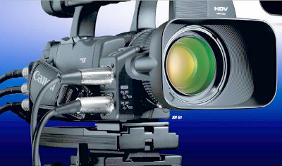

On page 2 of the Canon usa XH-A1/G1 brochure, bottom left.
What is that if not an hard disk?

Are you talking about the thing underneath the camera? That's the TA-100 tripod adapter.

If this is the picture you're referring to, then Tim is right, it's the TA-100 tripod adapter.

By the way, Chris--thanks for putting me onto that adapter. It's great. I thought I was going to have to take out the screws in the bottom plate of the camera, but it's not necessary. There are four threaded holes waiting for the plate. It seems just as solid as the big camera Sony adapter plates I've used for years, only shorter. All these years of bitching about the 1/4" sockets on the XL1 and XL2 and nobody ever told me this existed until you mentioned it.

Most professional tripods come with the 3/8" standard screw, and all bigger cameras have the same size receptacle. But the "handycam" style cameras all have a 1/4" receptacle. You put the tripod plate on the bottom of the Canon quick release, which has both 3/8" and 1/4" sockets. Also, if you have an XL2 or an H1, it will give you a better range of balance for those nose-heavy cameras. Since you can put the tripod plate directly onto the A1 with a 1/4" flathead brass screw, an adapter plate setup like this not really totally essential as it is with bigger shoulder mount cameras. However, if you're going to use different tripods and swap plates a lot, I think it's better to use one rather than putting on and removing things directly from the camera socket all the time.
Also, my experience with the XL2 was that the 1/4" socket was too shallow for standard size screws that were readily available. I was trying to mount one on an O'Cconor 50 (which is what I had with me at the time for a dolly). I didn't have enough washers to make the screw fit right, so I borrowed quarters from the soundman, wrapped them in gaffer tape, and made 4 little pedestals I taped to the bottom of the camera to works as a spacer. Crude but we got the dolly shot. My A1 will probably never go anyplace without the adapter plate.

If I bought the XH-A1, I would definitely get the TA-100. The TA-100 wedge plate is much smaller than any fluid head wedge plate and it's much more solidly attached to the camera with the four screws. All other cameras rely on the 1/4-20 hole and the VHS pin to prevent the plate from twisting. Also if you're using a fluid head that does not have a separate sliding platform and relies on the camera plate to set the balance (pretty much every low end head except Sachtlers or OConnors), you just snap the camera back into the TA-100 without worrying about if you've put the plate back in the right spot to maintain your balance.

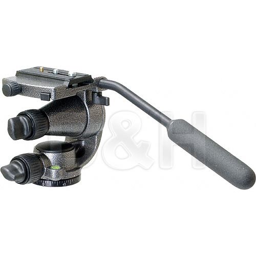

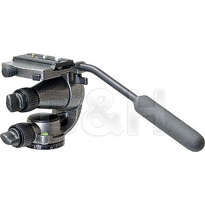

I have the Gitzo G2380 Video Fluid Head. It has 2x 1/4" Screws and a VHS Adapter Pin. I attached a picture. How does it compare to the TA-100?
