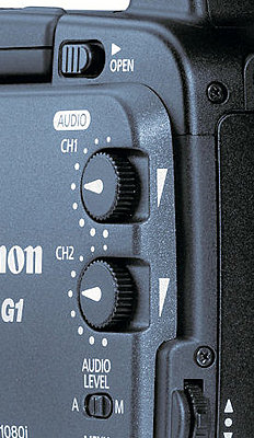

On the A1, the recording level can not be adjusted for each channel individually.
When shooting with my DVX, i always record in mono and achieve a stereo effect from the mono sources (especially atmospheres, which can be recorded A/B)
Normally, I record with one channel at letīs say almost 0 db headrom, the other at -18db as a safety in order to prevent distortion, using a mono field mixer or sometimes plugging the Mic in directly.
On the DVX, the channels can be controlled individually for doing this, but on the A1...?
Maybe a fixed resistor in the Audio cable would help to achieve this two level recording on the A1 as described? Any Ideas?
Incorrect. The A1 and G1 have separate left and right channel audio recording level controls. See attached image.

Chris, I think that he is saying that you can't do this with a single mic. You can only adjust left and right for two mics, otherwise they are tied together as the same levels. (This is frustrating and I wish could be fixed via firmware).
