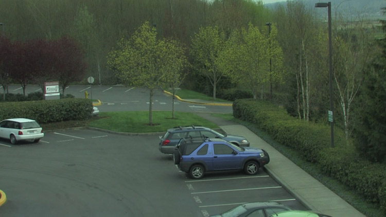

Okay, again, I'm working from a weird monitor so I need some objectivity.
Are you guys seeing any kind of cast on this shot?

too much red highlight.
can you control midtone on the preset?
Eric Weiss is offline   Reply With Quote

Not sure but this is going to do me for a neutral preset with vibrant colors. Doesn't look so vibrant right now because it's a dull day. I can more easily correct the red highlights in post :)

Stephen, some of your settings are similar to the ones I posted (before I realized I wasn't actually reaping them). Now that I have CP's turned on, I borrowed some of what you did, a subtle refinement, still a strong resemblance. Once I saw the effect of CPs, I felt my sharpness +3 was too high so I took that to zero. Since Cine1 gamma I also wasn't getting, and because I like the video-reality look of HD-Net/Discovery HD Theater I selected normal to be consistent with what I was getting before. After I got the matrix settings looking as close as I could get them, I was left with a slight green bias in the whites, saw what you did there and turned the green gain down, but -1 was all it took for me. I did not see the red push in the highlights the other poster noted from you picture, but I will look at it again on a different monitor.

Yeah, I don't really see a red highlight problem but the picture is small. These kinds of subtle color tones are sometimes hard to spot even on a 50 inch monitor. In fact it's definitely not a problem to even characterize it that way. If there is a slight cast it's hard to see. Perhaps the poster has observed some red fringing on the white pickup truck, or a faint red in the sky. The problem with faint reds in the sky, is sometimes they do exist in the scene and are not color casts therefore.

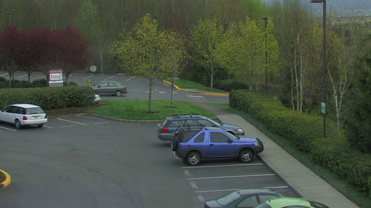

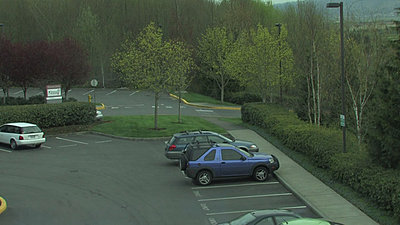

Tom, I loaded up your preset and there are two things that stand out about it:
1. It's a little muddy and/or milky in the midtones (I realize that can be made richer in post)
2. There is a definite green cast that I find distracting
Anyway, that's just my opinion, it may work for others.
Thanks for your efforts
Here's a comparison of the two:
Tom's on the left, mine on the right. Neither frame has been retouched, straight out of the camera.
Feedback needed for new preset-tom.jpg   Feedback needed for new preset-vivid.jpg
