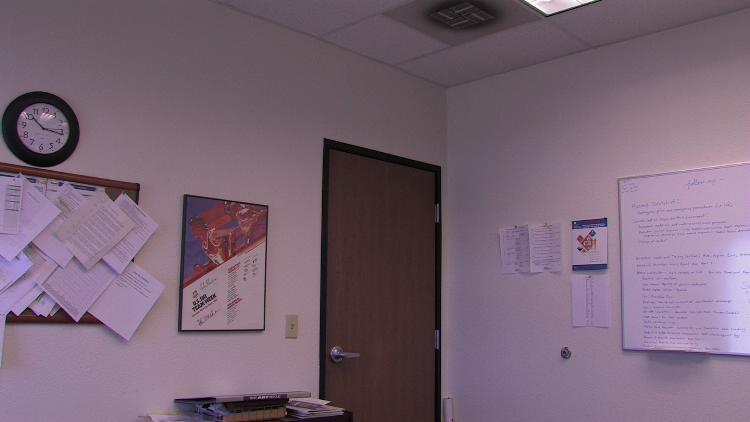

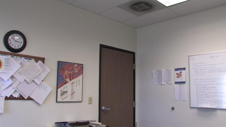

Steven and Eric,
Here's the thing, the grabs that came from Steven's cam using his settings are unquestionably closer to target. But what's unfortunate is that our two cameras seem to treat the identical presets much differently. I copied Steven's settings exactly. I shot a couple grabs in daylight and it shows there as a magenta push, where the street pavement looks pinkish. But it REALLY jumps out as a magenta push on the white walls and inside the shadows, as seen inside my office, so that's what I'm posting.
Steven, are you shooting with any kind of filter? I'm not. And if that's not the difference, this is unfortunate because it means presets are not calibrated between cams. Your grabs look best on your settings, but my grabs with your settings have a magenta push the equal of the green cast you saw on your grabs from my settings.
Steven's on the left, mine on the right.
Feedback needed for new preset-070405103012-00-02-02-14.jpg   Feedback needed for new preset-070405103012-00-01-58-14.jpg

My white balance for the test was set to the default daylight setting (56k) with no incremental changes. What is yours set to?

Originally Posted by Steven Dempsey View Post
Tom,
56k for the outdoor shot, AWB for the indoor shot, due to mixed lighting, cool white fluorescent overhead and daylight coming through the window.

Okay, we need to do an apples to apples test. Don't use AWB and certainly don't shoot a test under any kind of flourescent lights. Shoot an outdoor scene with the 56k settings and post a still and let's see how both settings look on your camera.
To be honest, I would probably develop a completely different setting for the indoor shot you are using in your test. Too much mixed lighting involved.
