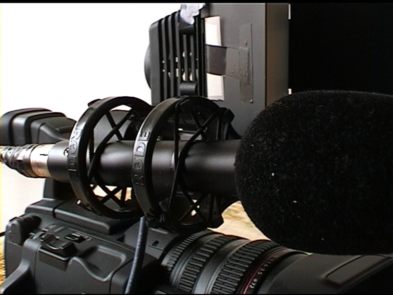

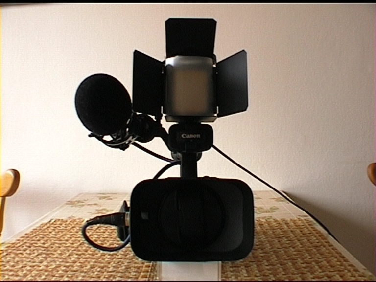

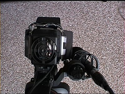

try this way of mount
There is no zoom noise.

Old June 12th, 2009, 02:29 PM   #45
Location: Huddersfield, UK
Posts: 469
Thanks Pavel. I had lots of problems with motor hum and your set-up inspired me. I bought the Rode SM5 shockmount (which looks like the one you've got) and it works plus it simply slots into the A1's holder. Hum gone. It's cheap too!
