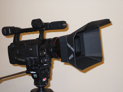

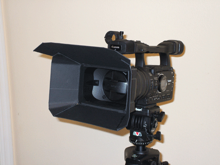

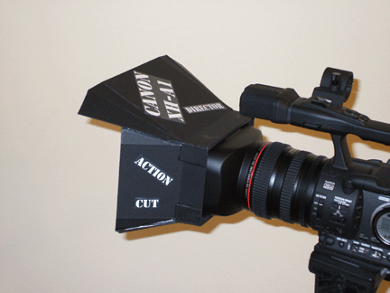

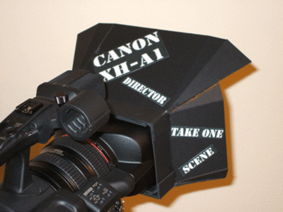

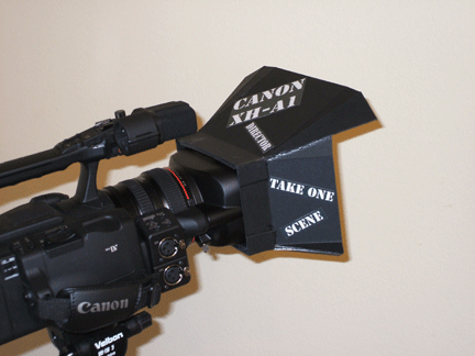

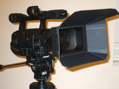

Attached are some pictures of a matte box I made for my camera. I plan to make another but instead of glueing it together, I want to velcro it so I can take it apart and keep it nice and flat in my camera case. Of course, I couldn't just stop at making it... I had to "decorate" it! :)
Stacy

This is simply a "shade box". Even with the supplied lens hood, I have been experiencing some unwanted lens flare while shooting my sons football games, so decided to make a bigger "lens hood" (out of matte board - hence: matte box). Thanks for the correction. :)
All-in-all It took about 2 hours to figure out the dimensions I wanted, draw it up in InDesign, print and cut out the template, and maybe another hour to cut out the matte board and glue it all together. The matte board has been laying around the house for about a year, so essentially it cost me about .50 cents in ink (I'm guessing) and about 3 hours total in labor. It works beautifully, I am happy!
