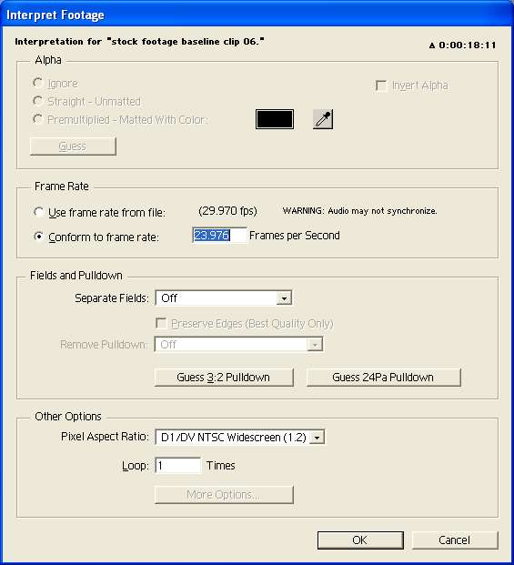

In the "Project" window, right click the file, choose "Interpret Footage", "Main" and make sure AE imported it correctly.

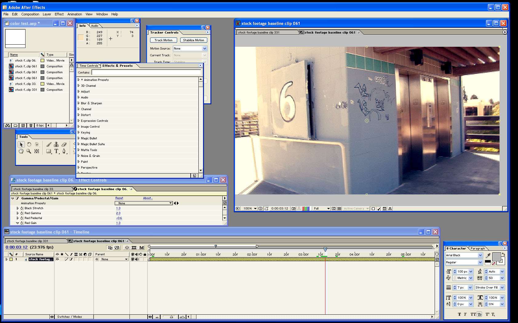

The toggle pixel aspect button worked perfectly, but when i told ae to interpret the footage as 24.976, the footage got even more liney

If the footage really is 24f it must be interpreted wrong.
These interlace artifacts on progressive footage can be caused by an attempted pulldown removal.
Make sure "Separate Fields" in the "Interpret Footage", "Main" dialog is set to "Off".

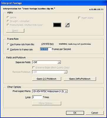

The seperate fields is set to off- but im still geting the the same thing

But I think that in SD (miniDV) the XH cameras only record 24F with pulldown. So your file is actually 60i using either 2:3 or 2:3:3:2 (whichever you've chosen in the camera's menu). So you should be able to get rid of the interlace artifact by conforming to 23.976 as you've done and then either letting AE guess the pulldown, or telling it in that same dialog which pulldown to use.
