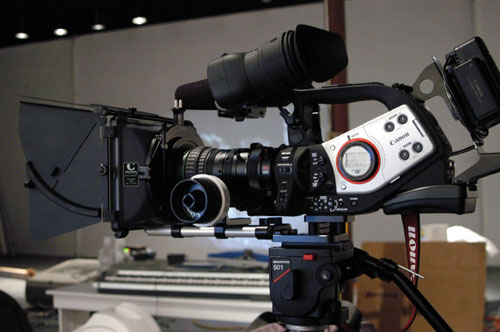

I use the Chrosziel 4x4 and always shoot 16:9 with no problems at all. I use the 16x manual, but I have used my 20x on it as well with no issues.
can i use a 4x4 matte box if i shoot 16:9 with XL2-xl2.jpg

The accessory bracket on the back of your XL2 - I have one too, of course, but I have never used it. It looks like you have multiple batteries on yours. How does that work? I have five batteries, I think, but I just put them in one at a time.

That's the dual battery holder/charger on the back. I don't remember the model number (it's made by Canon, not 3rd party), but I bought it back when I used my XL1. It holds two batteries at a time and plugs into the camera.

This is the Dual Battery holder bracket and holds two small or two extra-heavy duty batteries via the Dual Battery charger/holder. The bracket also can hold a radio mic unit.
For extreme longterm shooting away from a power source, I prefer to use a separate XL2 battery belt with wire connected direct to the XL2 body.
