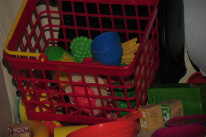

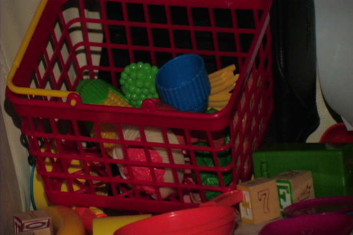

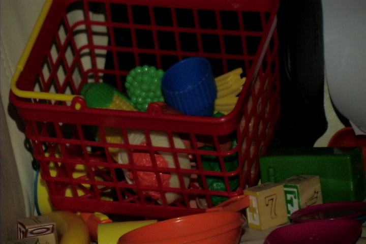

I exeperimented in a dark room with the VL 10LI light, XL2 about 10 feet away from some different colored objects. Set at 24P 16x9 / Manual white balance / shutter all the way open / manual focus / +6dB for all shots. See attached grabs.
Here are the settings that I came up with. I know it would be best to do this in the field. But it's pooring rain out. Any additional advice is appreciated.

Hi Tim. I was going through this thread again because I have to shoot a rock band at a club this evening, and I have no idea what the lighting is going to be like (except that it is out of my control). Thought I could pick up some tips for dark background situations. Then I found that I couldn't see any difference between your haunt -1, -2 and -3 presets. Is this a copy/paste issue or am I missing something obvious?

There's not a whole lot of difference. But just look at the blue toy, and you can see a slight difference.

Hi Adam. I can see clear differences in the frame grabs, I was talking about the preset parameters that Tim listed, they look the same to me. For example, if I set the camera to get the look of haunt-1, what would I need to change to get haunt-2?

If you look at the grabs you will see a black lense carrying bag behind the red basket. On the right side of the bag you can see the some writing. (i.e. manufacture name). This is most clear in haunt-3. Looks like more detail in the blacks in haunt-3 and haunt-1, less detail in the blacks in haunt-2.

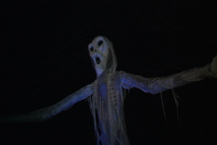

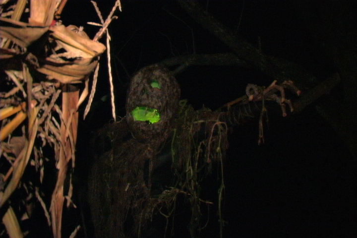

I used the haunt-1 setting for my haunted yard project. In all cases I had to use the VL 10LI light, which by the way... was worth every penny. Attached are two grabs.
ghost.jpg - The ghost is 34 feet tall. I used haunt-1 with the gain at + 6 dB, 24P, wide open aperture, manual white balance & VL 10LI light.
monseter.jpg - About 8 feet away. I used haunt-1 with the gain at + 6 dB, 24P, wide open aperture, manual white balance & VL 10LI light.
Sorry I did not see your post yesturday Richard. If the band does not have stage lights then you could be in for a rough go. The VL 10LI light works great in run and gun dark situations.
