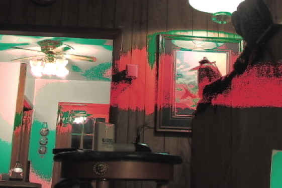

Today I took my xl2 out of the camera case and turned it to tv and in the view finder I got a red background instead of a blue one. When I panned I got reds and greens all over the place, kind of like blotches or sections still showing what you record. I haave inclosed two stills to show what I mean.
the camera worked great last day and nothing has happened outside of normal!!
I tried a couple different sizes and settings, hope they do!!
record problem, help-xl2-problem-smal.jpg   record problem, help-xl2-problem-3.jpg

I forgot to mention when I play a tape it plays the colors true as can be.
I tried different tapes too, just desperate.

Unplug your camera EVF
Take out the small Lith-Ion battery
Remove the power source...battery or AC.
Let it stand for 20 minutes. Let us know how you make out....

Thanks for the advice. I never did try removing all the power sources. I waited a week and had no responses so sent it off for repairs. It cost twice as much to insure it than it did to ship it!!
I will keep that info in my mind for the future. It did not make sense, it was perfect one day, placed in the case taken out 2 days later or so and it was waxed!! We did some serious off road driving and all I can think is it was to jostled around, weird stuff. When I get the report back I will post the post mortum on it.
