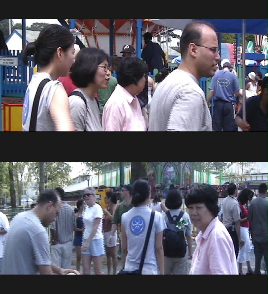

A couple years back, before DV cameras put a high quality 16:9 mode as standard, I sought to take advantage of my new widescreen TV.
The Century Optics 16:9 anamorphic lens for DV cameras was too expensive for me, so I looked for other options.
After reading Ben Syverson's widescreen page, [which is no longer available, but you can read it on the Wayback Machine]:
http://web.petabox.bibalex.org/web/2...een/index.html
I went ahead and found a film camera/projector Bell & Howell 2X squeeze lens on eBay for like $80 and was able to mount it with a Series 7 to 46mm thread adapter.
The anamorphic 2X squeeze len---which squeezes only in one axis-- doubles the width of the 1.33 frame, so you get--voila---2.66 full scope!
Since the lens is made for a film camera, you had to zoom in to remove vignetting, and I had to back up while shooting.
But the results were fun and quite amazing.
I had to scale/letterbox the full image onto a 16:9 DV frame show and then make a anamorphic DVD out of it.
Of course, there are many problems working with this "format". You had to make sure your horizons are level. You have to make sure your lens is completely vertical when mounted on the camera or you will get your fun house mirror effect, where everything is tilted.
The best part of the lens is the cool "effects" inherent in this type of lens. Light flares, bumps and mumps, when you pan across a room. Just like how "Die Hard" looks on film.
In essence, with that 2x lens, I was shooting "Full scope"
I did eventually buy that Century Optics lens, and later I did get a PDX10.
And yes, I briefly tried the double 16:9 trick with the Century Optics on the PDX10--and it definitely works---but I don't think you get the kind of the distortions like a real 2x squeeze lens.
It was fun shooting my "Cinemascope" home movie "masterpieces", but ultimately, it was pain in the butt.
Attached are frame grab examples.
Native 2:35:1-scope.jpg
John C. Chu is offline   Reply With Quote
