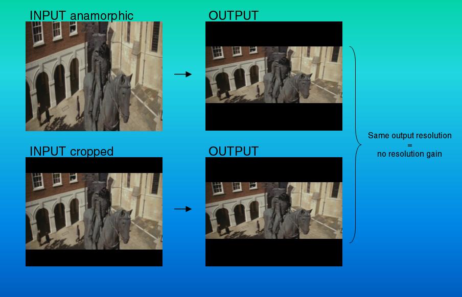

Mike, I understand what you are saying. And yes, with the adapter, you don't lose resolution, because you use the full width of the sensor. BUT BUT BUT, when you output this to the most popular format such as DVD, what I'm trying to say is that the FINAL RESOLUTION of the anamorphic footage, and the cropped footage will be EXACTLY the same. This is simply because DVD doesnt support 2.35:1, so the frame still needs to be cropped. Therefore the only advantage of the lens is the extra wide angle, which you can simply achieve from a wide adapter. I'm attaching an image to explain what I mean. The only reason you would go for an anamorphic adapter with the XL2 is for simply for the look of the extra wide angle, which I don't like anyway because you only get barrel distortion with it, you'd only want this look as an effect. The CANON 3X would be a better investment, just for the occasional shot.
Don't get me wrong, I love 2.35:1, I think it looks awesome. But if you want that wider look, you'd just get a wide angle lens. The canon 3X would give you a much clearer image than any adapter would. And, as I said, if you're outputting to DVD which most people are, the resolution will be the same no matter what. It's simply the look that you would be after, and the true Canon 3X or any high quality adapter would do better than a cheap Panasonic adapter.
Native 2:35:1-comparison.jpg

The advantage of the anamorphic comes in the intermediate process. I’m sure effects are easier to do with the extra resolution however small it might be. Basically is however you like shooting. I personally shoot all of my stuff in 2.35:1 so I would love to have one of these, to bad I’m so poor all I can afford is a plane XL2 (that’s sarcasm in case the tone doesn’t come through)
Optically is always better then digitally when it comes to this subject and anamorphoic just makes stuff look cooler. Most people dont notice the differences but anamorphic treats blurry lights differently the extracted 2.35. It also has a few quirks with it that I actually kinda like. Basically anamorphic 235 and matted 235 look different and its all about taste and what you are shooting.

I see what you are saying, but i do enjoy being able to get a 2:35 frame during shooting so i can better frame things, and actually what you are showing us all is the same thing they do with film. They either shoot anamorphic or if they used Super 35 they just crop the 2:35 image from the square frame!
I prefer shooting anamorphic its just me.
i guess it all comes down to personal choice.

Nic, you had me convinced for a minute, but then I started thinking more deeply about it, and it seems to me now that shooting with an adapter is indeed better than cropping.
First off, if you shoot with an adapter, the horizontal squeezing occurs before the camera downsamples the picture information and applies the DV compression. As a general rule, I find that it's always better to do something in the camera before compression if it's at all possible, whether we're talking about aspect ratio, color balance and saturation, gamma, or any other kind of image manipulation you can think of.
Second, if you crop in post, you're not outputting the full 720x480 NTSC raster as it came from the camera, but only the center portion of it; even though both images end up being exported at the same resolution, you're using all of the information that originally came from the chips if you use an adapter.
The above being said, it's clear to me at least that shooting with an optical adapter would in fact give you better results than cropping would.
