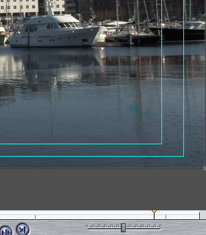

I just bought a A1 and I have a cluster of blue/greenish pixels 'dead' if you
like stuck on my footage below right hand side corner. I looks like a good chunck of pixels and I am puzzled about it. Been taking some footage with Steven Dempsey's Panalook and vivid_RBG custom preset's as well as Will Schryver's Rich_RGB and it appears on all settings as well as in the viewer and LCD screen. All was shot HDV at 25f.
Will try see if also apparant in SD and if can will upload a screen shot.

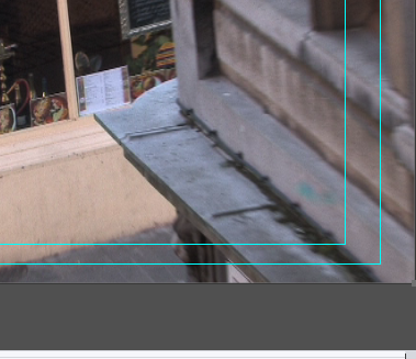

Just checked a SD test and the same pixelation is occuring on the footage
there also. Blue/Greenish spots in same positions. I somehow cant make
attachments (guess newbies not allowed) but it is very clear on the screen
shot taken from FCP.
I am wondering whether it could be a lens problem????? but I checked
it with/without the UV filter and cleaned the lens (althou not with any
chemical solutions just the dust clotch) several times now to no avail.
Will see if I can figure a way to attach the screen shots.
Any help will be much much appreciated.

Here is the screen shots both SD and HDV.
Help!!

Henrik,
I am sorry to say that the images you posted look nothing like the problem I am having and I don't think they are lit pixels, at least not the way we are thinking. Mine are little tiny "pin points" of light, like the way a star looks in the night sky, but brighter. I have never seen your problem before and highly recommend you get it looked at immediately. That is not normal.

Anyhow, I also now found 1 LIT pixel, looks like a shining star with a bit
of black around it but obviously the posted screen shots are quiet clear
Thanks for resting my mind that this is not normal.
