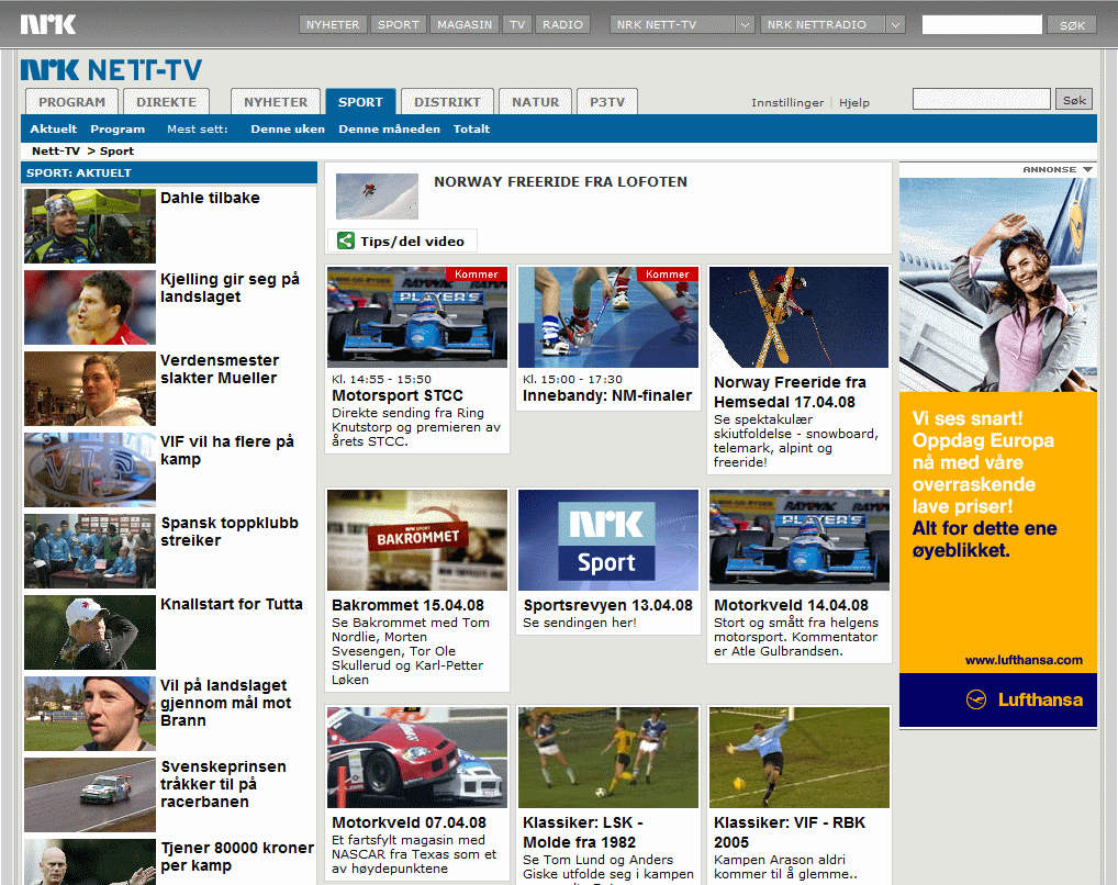

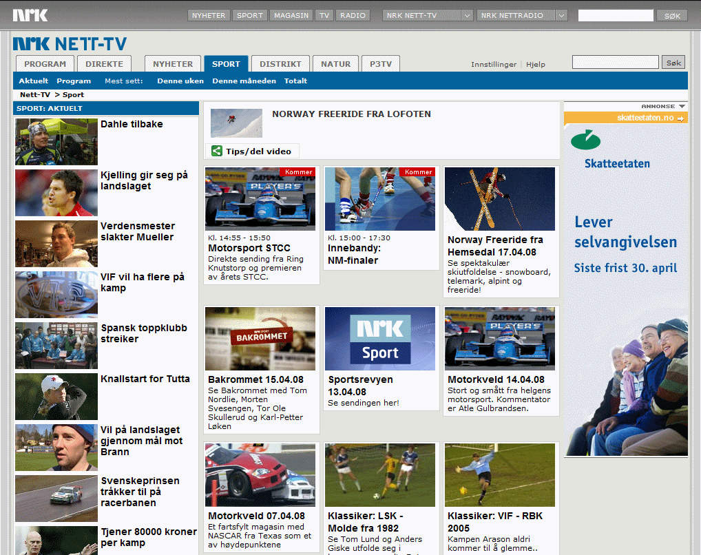

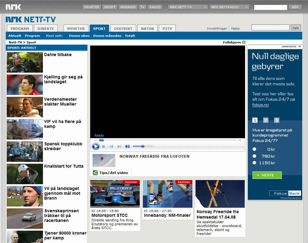

I went to your page http://www1.nrk.no/nett-tv/sport/spill/verdi/50105 to view the video. The vid would not play and the error message I got was to do with the way the video was embedded.
The video dislay holder works in Internet Explorer but not in Netscape or Firefox in fact your page structure fails in the latter two.
I have attached screen captures of what I am seeing. They have been compressed so their picture quality is not great but at least you see what the browsers are doing to your vids / pages.
I would recommend changing to flash (.flv) embedded videos, I can give you a link to some pages with them embedded in a private mail if you desire. These work on a much higher percentage of user machines. Regards, Dave
I have added the fourth image which is an .flv videoin a Firefox window.

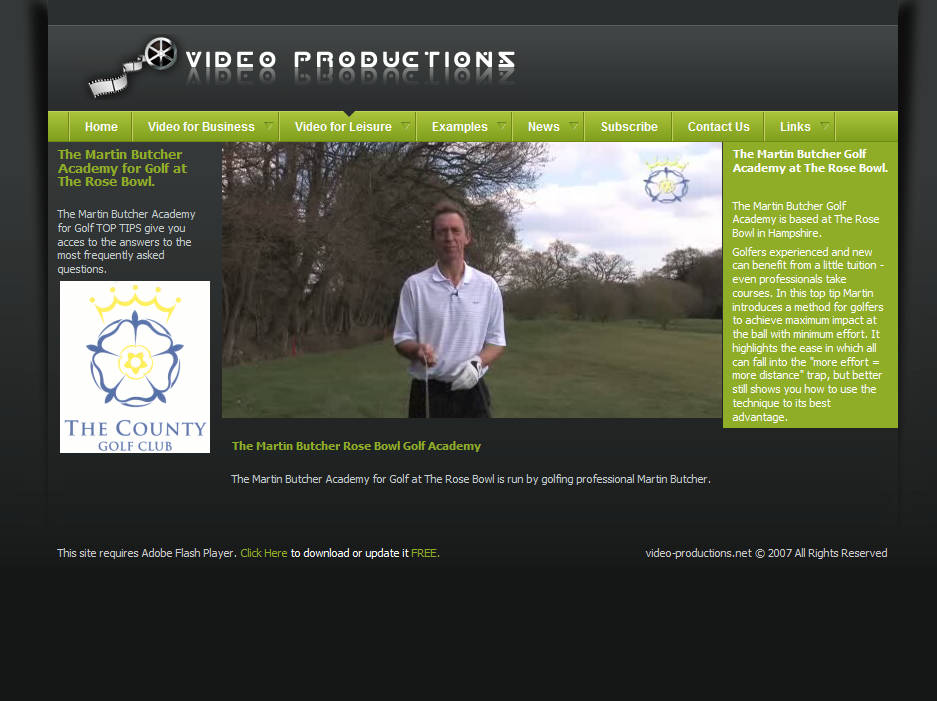

A possible solution if you are not in control of the page could be to switch to using .flv video files.
For instance, I produce all our web versions in 16:9 format to a 500px wide X 280px High screen size. It might be worth a try, if you don't give them a wmv video they have to adopt to your different style I would have thought.
You can obtain the latest originals of the mediaplayer.swf and swfobject.js files from the manufacturers site: http://www.jeroenwijering.com/?about...V_Media_Player
The code to place the embedding is only two pieces.
1. In the header section place:
<script type="text/javascript" src="swfobject.js"></script>
2. In the body where the film is to go use this code which forces a holding table around the film. thereofr everything has to move around it:
<script type="text/javascript" src="http://www.video-productions.net/newplayer/swfobject.js"></script>
<div id="flashcontent" align="center"><strong><center>You need to upgrade your Flash Player in order to view the presentation</center></strong></div>
<script type="text/javascript">
var s1 = new SWFObject("http://www.video-productions.net/newplayer/mediaplayer.swf", "mpl", "500", "280", "7", "#ffffff");
s1.addParam("wmode", "transparent");
s1.addParam("allowfullscreen","true");
s1.addParam("bgcolor","#ffffff");
s1.addVariable("file","/videoprojects/MBT1_512K.flv"); (this is the video line)
s1.addVariable("enablejs","true");
s1.addVariable("javascriptid","mpl");
s1.addVariable("displaywidth","500");
s1.addVariable("displayheight","280");
s1.addVariable("autostart","true");
s1.addVariable("overstretch","false");
s1.addVariable("lightcolor","0x00ff00");
s1.addVariable("backcolor","0x212121");
s1.addVariable("frontcolor","0xCCCCCC");
s1.addVariable("bufferlength","4");
s1.addVariable("smoothing","true");
s1.write("flashcontent");
</script>
