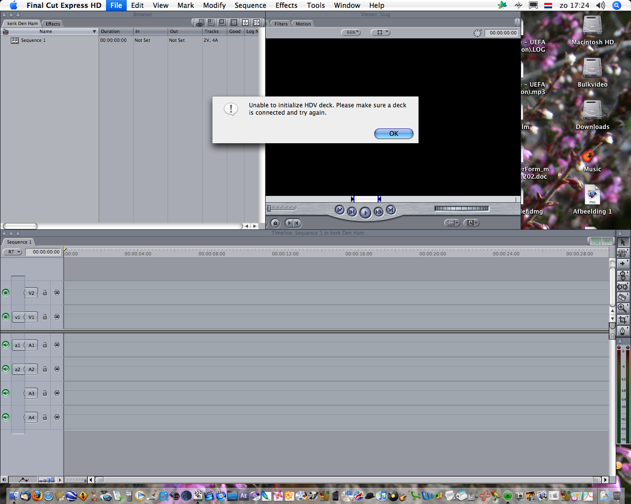

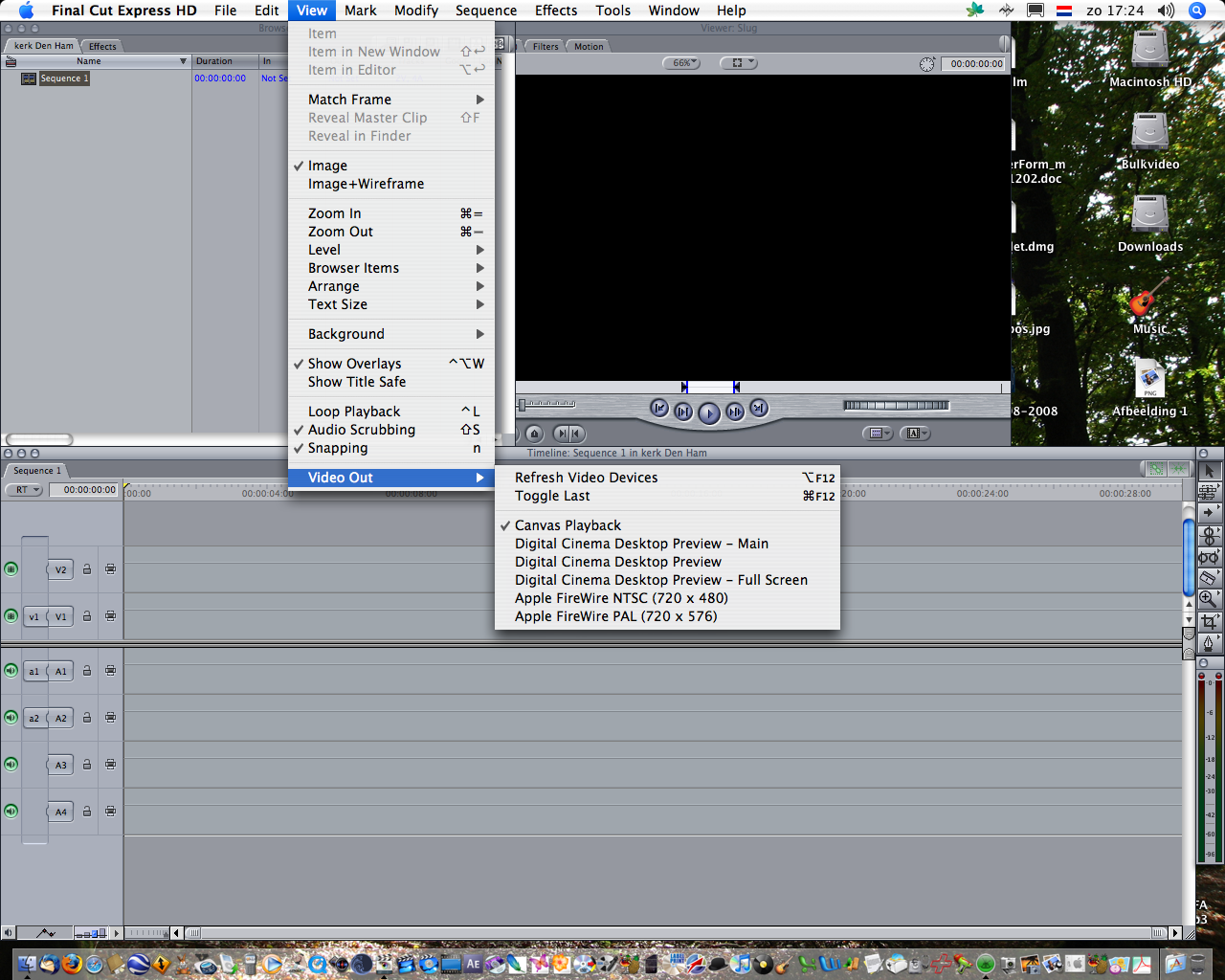

I've got a similar problem...but the solutions mentioned above don't work with my XLH1...
I want to capture video from the deck (it's HDV 1080i 50 PAL footage) into Final Cut Express HD, version 3.5.1.
In FCE I can't select an HDV camera under 'VIEW' > 'VIDEO OUT' (see pic).
When I want to start up the capture mode in FCE, it says it can't find an HDV deck (see second pic).
What should I do?
Thanks for helping!
