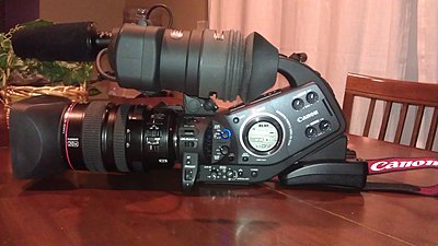

Okay guys, I am now the new owner of the XL H1A. Or at least I think I am. Per the serial number, it is an XL H1A but on the actual camera exterior, it say XL H1. Although it has a Canon lens, it is only a two ring lens. I believe it is a 5.6-108mm lens 20x zoom. The good news is that the camera was purchased for less than $2500.00. I was actually able to get the camera for only $1800.00. The bad news is that having had the camera now for 2 days and gotten a Chan e to play with it, all of a sudden there seems to be an issue with the cassette tray or the heads. The footage seems to start and stop during playback and doesnt appear to be accurately reading the time remaining on the tape. As a short term solution until I can get it to Canon, I'm going to try capturing footage direct to a hard drive via the fire wire. If this works out, Nanoflash here I come.

It definitely sounds like you have an original XL H1 and not the H1A. The H1A has 3 rings on the lens and no HD-SDI port/Pro JackPack.

Thanks for the clarification. Whats interesting as a mentioned earlier is that on the inside of the battery compartment it clearly says XL H1A. I'm wondering if the guy that sold it to me gave me the lens from the XL H1. But then again, it does have the SDI Jackpack. Couldn't that have been added if he took the old XL H1 and tried to combine the two?

If you obtained an XLH1 truly with and HD-SDI port for $1800 with the only 2 lenses ever made for it, then you have a wonderful camera. Add a nanoFlash to record 4:2:2 at a plethora of bit rates and you have a killer combo. Bear in mind that the original XLH1 passed timecode and audio out to external recorders via a timecode jack and XLR connectors. Whereas the XLH1S passed timecode and audio within it's HD-SDI signal.

Yup, definitely the original XL H1.
