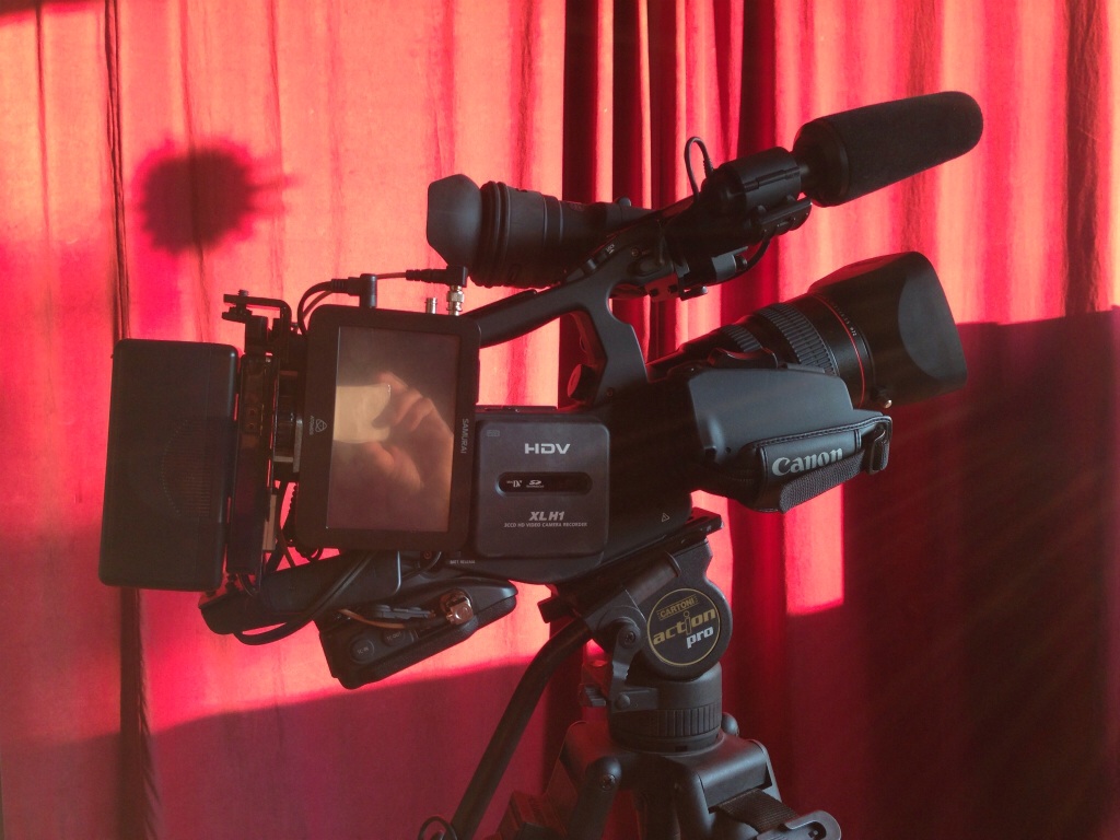

I use the Samurai with my H1. I find out how to fit on the H1 for using as shoulder cam:
XL H1 w Samurai still make sense w. all the new options out there?-image.jpg

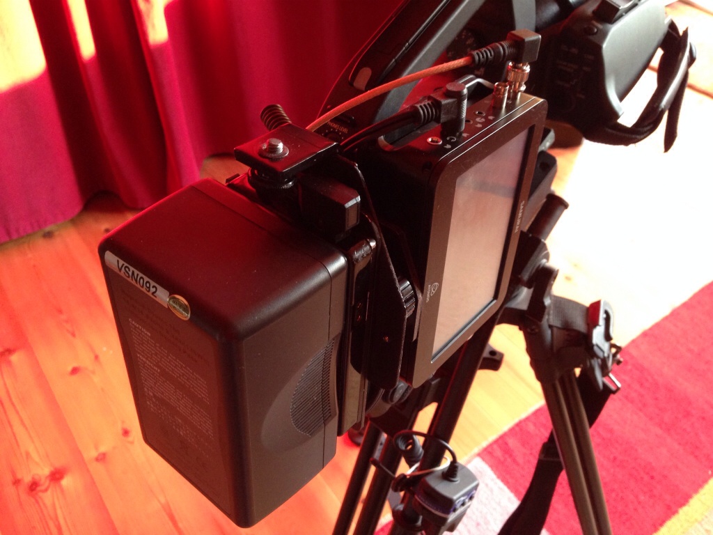

One more pic:

Thanks for the pictures. Does the Samurai allow you to record audio direct to file or do you need to use a separate audio capture device? Also, how is the image quality in comparison to what you get without it?
Maurice Covington is offline   Reply With Quote

Re: XL H1 w Samurai still make sense w. all the new options out there?
I record Audio direct to the file through the analog input. Had some trouble with that. You need to switch battery management in the Samurai to Anton Bauer adapter, to prevent clicking every second. I use a LANC cable, inserted tape and free running timecode to get record the Samurai with the record button of the camera. Locking the screen from the Samurai prevent unexpected recordings.
Samurai sound recording quality is equal to the sound recording of the Canon tape recording. I set a delay of two frames for syncing to the picture.
