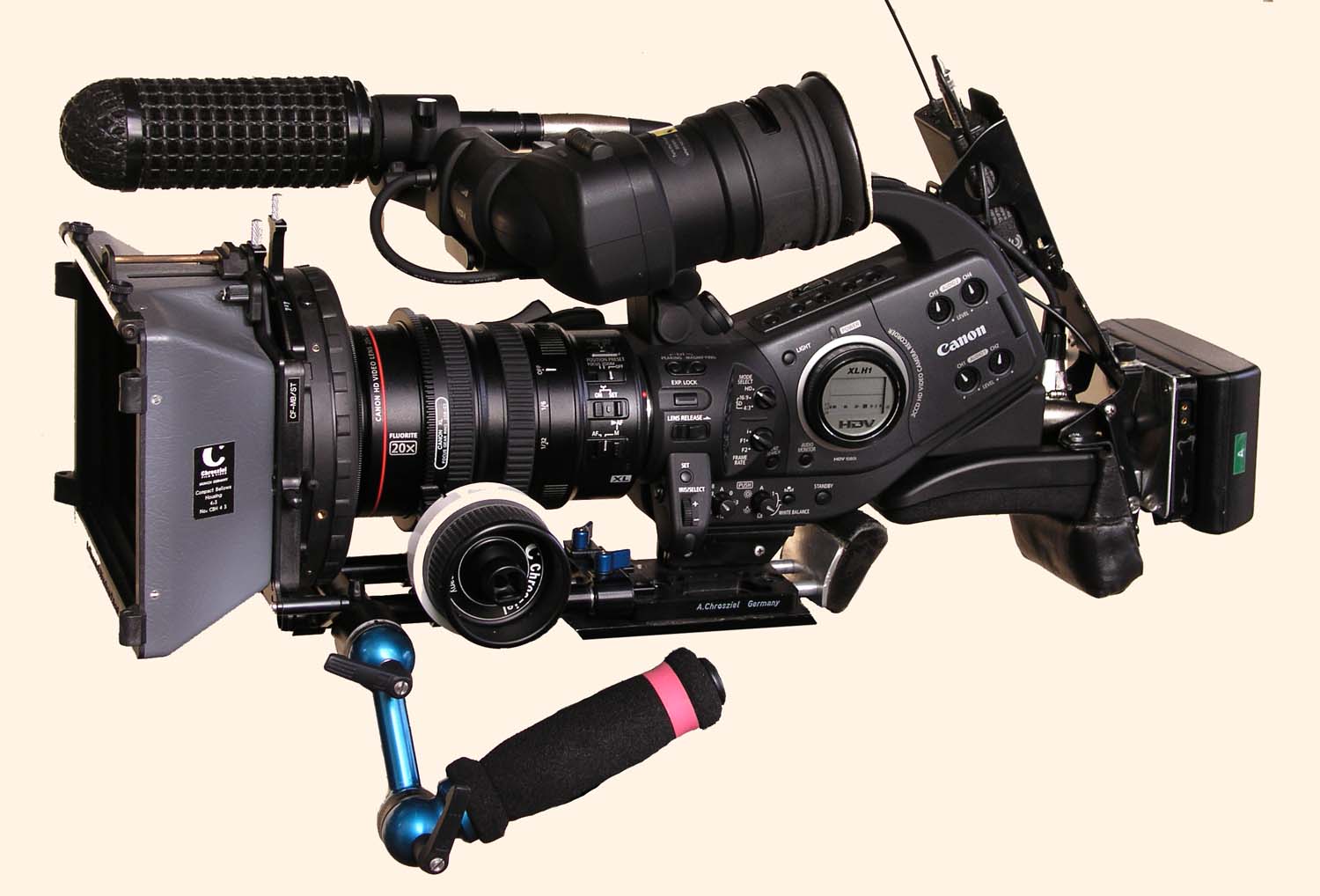

Here's the way I've set up my camera for documentary filmmaking. I should note that I have always modified my cameras to suit my shooting style.. back in the early 70's I modified a 16mm Bolex to take 400' magazines mounted on the back, which involved reconfiguring the optics of the viewfinder..
This camera (the H1) is much easier to customize because it started out close (but no cigar)... The way it is set up here, the camera can be mounted and removed from a tripod without removing or adding pieces.. The grip setup is one I've had for 10 years that I use on my Aaton super16 camera. The nose mike is an AT, the wireless receiver is Lectronic, battery is Anton Bauer Hytron50.. the empty place on the back, above the battery, will hold a Firestore FS-C when it's perfected for HDV. Oh, and the pink band around the grip is a rubberband that they use to tie broccoli in the field - I was shooting fieldworkers for a United Way doc last month and stuck it on for good luck...
As I said, it is heavy, but the weight is well balanced... I often use the 3x3 Chrosziel instead of the 4x4 compendium matte box in the picture to save some weight though...

Looks pretty cool Steve. Is the Chroziel FF standard or did you modify it. I'm assuming if you're using it you must like it.

FF is standard "DV" unit - I got it to use with the 16x, but it works so well with the 20x that I tend to use it (the lens) more than I used to... I like this model because the focus scale is on the side of the focus sleeve, so you can see it from the viewfinder.. with the 16x I have another sleeve painted with the distance markings, so I can estimate focus from the viewfinder.. The matte box base is slightly modified, strengthened, and the front shoulder support is attached to it.
By-the-way, all of the modifications were done with the proverbial "simple hand tools" and the materials are: aluminum pieces that I bought at a hardware store, dense foam left over from cutting a case insert, and black leather cut from a purse I got for a buck at Good Will...
