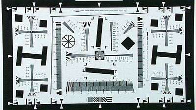

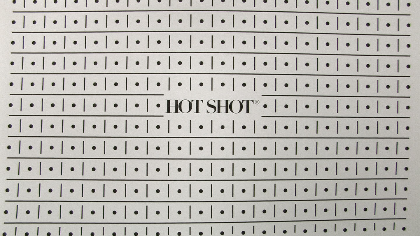

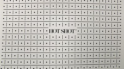

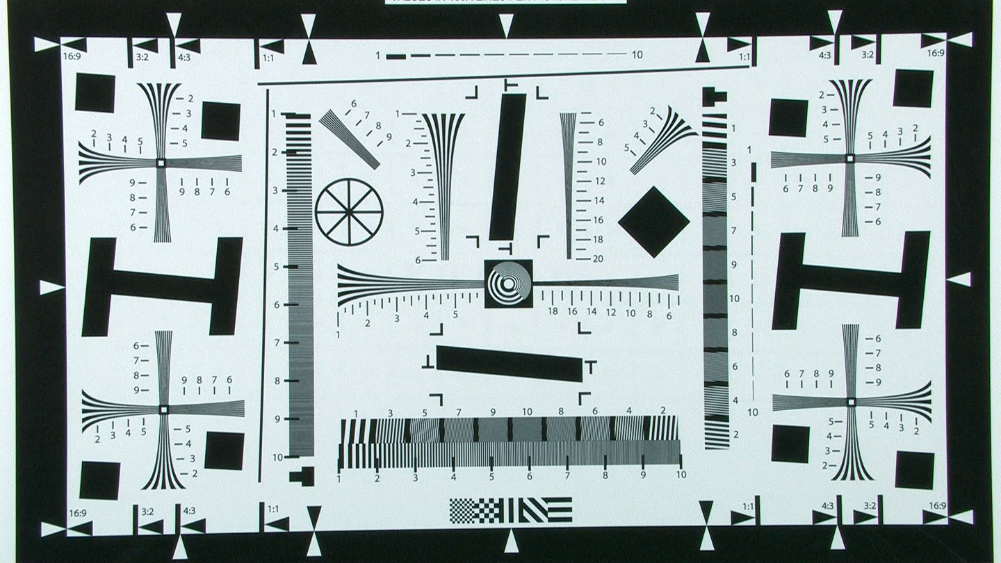

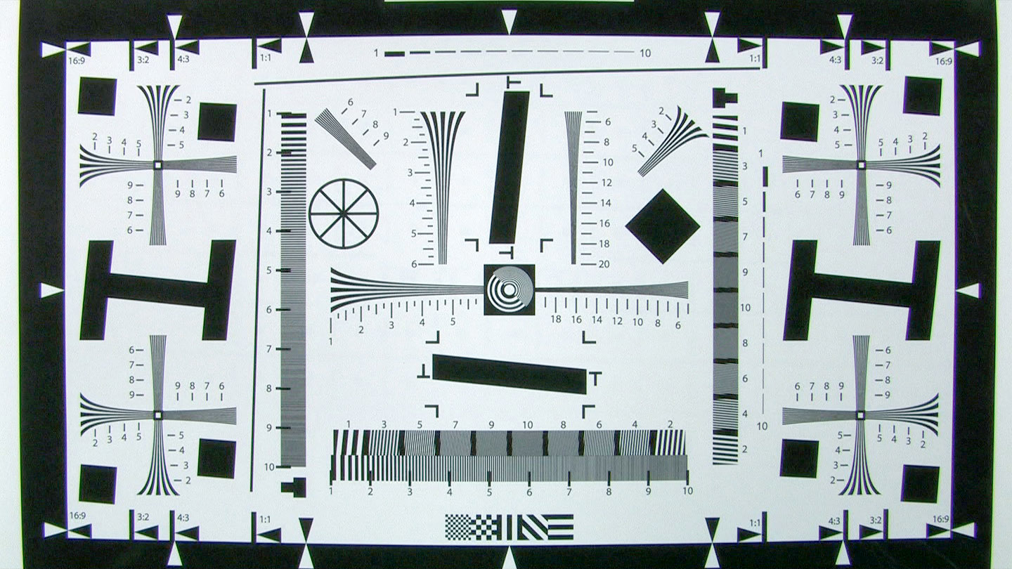

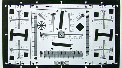

OK. Here it is. I've done the back focus, pictures is frame grabs.
Barrel distorion; Chart and some shots done at my studio.
Resolution Charts; at full wide and full tele.
Depth of field; with help from my assistent Linda, one at full wide and one at full tele (shot with Schneider Black Frost 1/2).

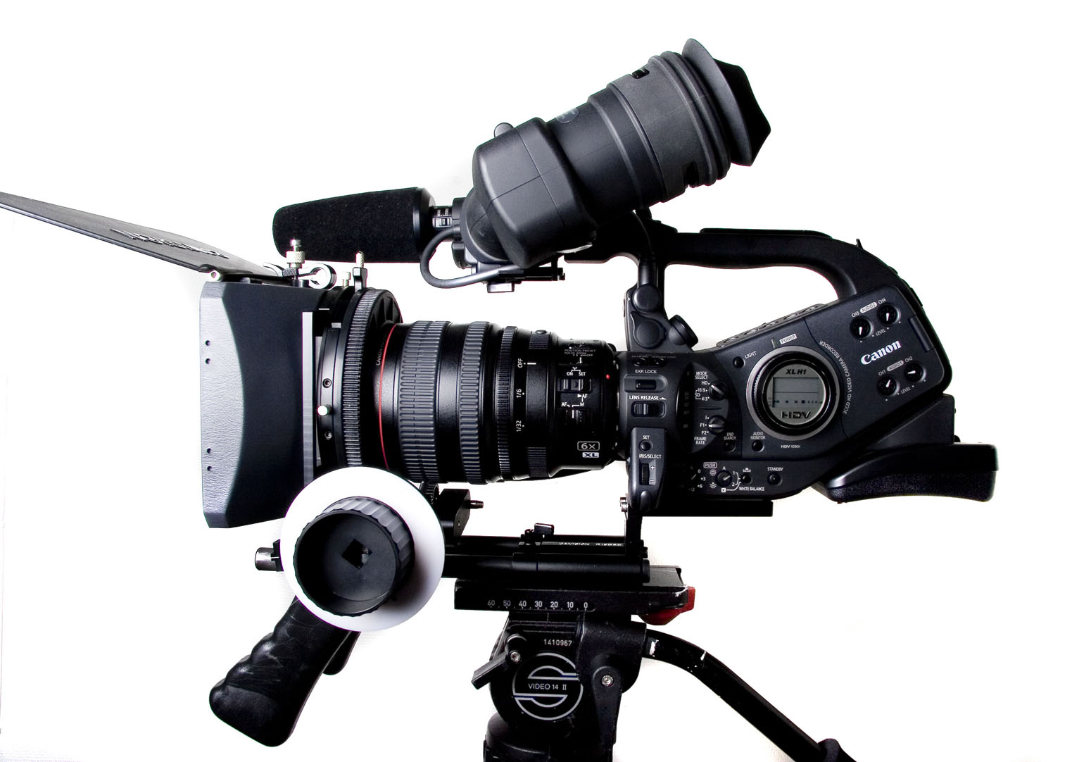

And here is one more on barrel distortion and one pic on the 6X mounted on the H1 with rod system. For gear ring (follow focus) we will need a gear ring with 34 cm circumference.
