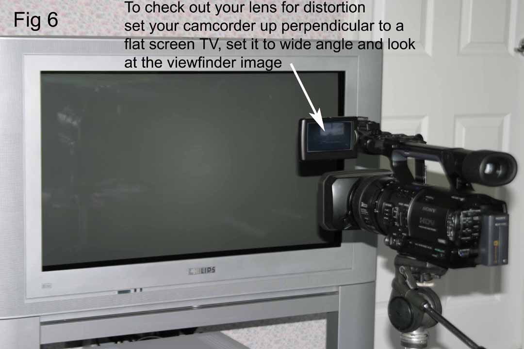

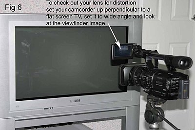

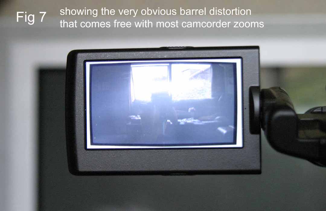

The distortion is enough to make me wary of using max wide-angle as I track through buildings, because door frames that bow outward as I pass through them do not look good to my clients. If you've got a flat-screen TV, try this: stand in front of the TV with your camera perfectly perpendicular to the screen. Zoom to wide-angle and move so that the TV frame fills your v'finder frame. I’ll bet the results surprise you. As you move further away though and zoom in, things begin to look better and the barrel distortion lessens. On the Z1 you've got to go to 12 on the 00>99 zoom scale to get zero distortion. All is not lost though. My single element Bolex aspheric (a 0.5x) actually cures the Sony’s barrel distortion to some extent. At full wide-angle it’s still barrel distorted, but zooming in a bit gives perfectly straight lines.

As I show in the picture: Barrel Chart @ full wide.jpg, on page two in this thread, there is a obvious barrel distortion. I should have done the picture on a larger chart, so I could fix the cameras CCD really parallel with the chart, but it is there and you can see it.
Compared to the Z1 EVF picture (which have the widest focal lenght 32,5 mm in a 35 mm SLR camera comparison, the 6X zoom has 24,5 mm), I get the overall impression that the barrel distortion may be equivalent or less (I assume that there isn't any wide angle adapter mounted). Compared to wide adapters I have used mounted on the 20X the barrel distortion is far less!

Yes, my shots show the Z1's 12x zoom at its widest angle and it's well known for its barrel distortion. But my Bolex Aspheron (a 0.52x converter lens that limits the Zeiss zoom to a 6x) doesan't add *any* barrel distortion, and that's filming at a 17 mm equivalent focal length.

You're quite right Jonas - anything placed in front of your front element will degrade the image quality to a greater or lesser degree. But folk fit softening filters, thick polarisors and so on - so absolute image quality isn't necessarily the only Holy Grail.
So it goes with the Aspheron. This is a single aspherical glass element made by Bolex in Switzerland, beautifully Zeiss T* multicoated and it costs. But the ace up its sleeve is the 17 mm (equiv) focal length and the fact that you can track room to room and not have the door frames bow outwards as you pass through them.
Anyway, if we make movies that have people watching the edges of the frame looking for chromatic aberations, then we're not really getting the audience effect we're after. The 17 mm focal length is wild, but at an actual 2.3 mm the lens must be absolutely *spotless*!
