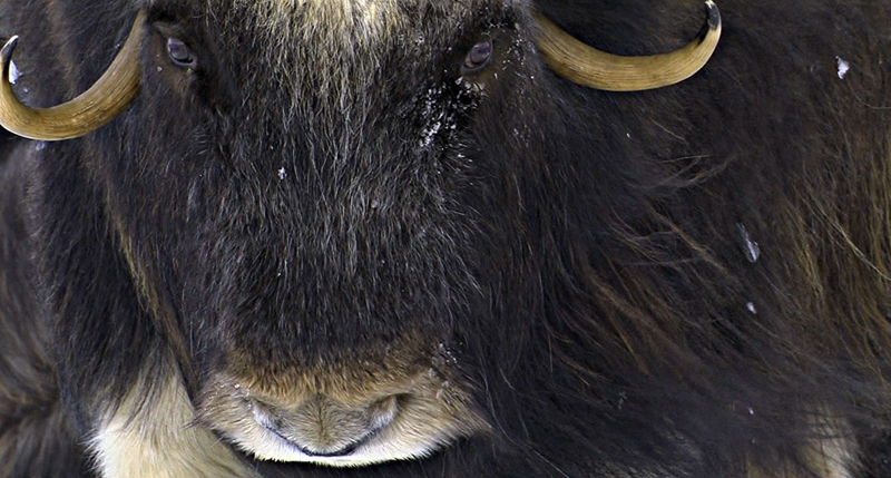

Will, I was told by the Canon rep that to multiplay with 7.2, so the actual focal lenght of the 500mm is 3600mm!
The sample above is just a first tryout. I have been shooting alot with it recently in my muskox project. I got very nice close-ups with it. The picture is a screen capture from a shoot I made. The distance to the muskox was approx 40m and this was the framing I got! Very scary to view on my HD-TV.
