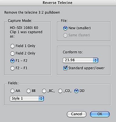

Michael,
It's a PITA, but the method I've found that works the best is to create self contained QT's of your different clips, where each clip has the same cadence by starting/making the in point on an A frame (first of 3 progressive frames) and ending/marking out point on the second interlace pulldown frame. (last of 2 interlace pulldown frames) Export the clip and then bring into Cinema Tools.
In Cinema Tools, Open the clip and click on Reverse Telecine. Then try these options and render out a short clip to see if it works. See attachment for Cinema Tools settings that I use.
Btw, for some reason Cinema Tools saves the clip with a default display of 640x360. Don't worry, it's just displaying that--go to the QT View menu and click on "View/Actual size and you will see full raster frame. :) Click on "Save" in QT and it will come up as a regular 1920 x 1080 clip from then on.

XL-H1 HD-SDI 3:2 pulldown removal question-cinematools.jpg

I tried this, but it still doesn't work. I tried all combinations too, but none work. Any other suggestions?
