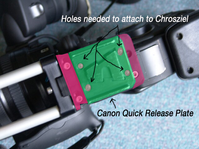

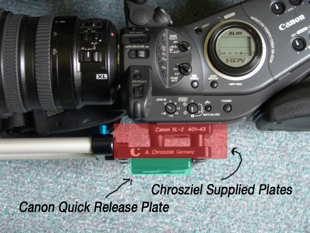

Be careful....though. We have the quick release "Sony Style" plate for the Canon..
Chrosziel mounts a plate onto the bottom of the Canon....for the rods. You must then take the Canon plate...and mount it to that....unfortunately...there are no holes drilled in the Chrosziel for this. I had to take our to a machine shop...to add holes...so I could mount the Canon plate onto the Chrosziel plate...
When I get back from my location shoot this week...I'll post some photos....because I know this sounds confusing.
Ultimately....I love the matte box...but some modifications were necessary.
I told Chrosziel about it...but I don't know if they did anything to rectify the problem. That was July of 06.
Kevin Martorana is offline   Reply With Quote
Old June 17th, 2007, 11:37 AM   #5
Location: Lancaster, PA
Posts: 250
Okay...I hope I can explain this well.
As you know...the Canon XLH1's lens is not directly 'in line" with the rest of the camera.
When we got the matte box... Chrosziel supplied a plate that screws into the bottom of the camera. It is off- set, to allow the rods to line up with the lens. Very easy to setup.
BUT....The Canon quick release plate...(which was screwed into the bottom of the camera before...) now...has no place to live.
The Canon plate fits the Chrosziel fine (side to side and top to bottom)...but there were no tapped holes to attach the Canon plate....to the Chrosziel plate.
We took the plates to a local machine shop....because we didn't want to screw up any tapping....and had them do the drilling. This cost aboutt $80.00 to drill 4 holes....
BUT...the completed project works well....is tight...and easily lets us quick release from the tripod...with mattebox attached.
I dont' know if Chrosziel has addressed this problem....but the Mattebox and rods and all accessories work well.
