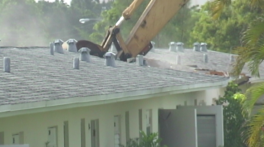

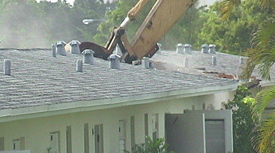

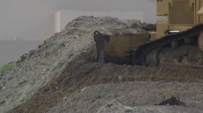

Technically, vertical resolution is lower in 16x9. Practically, does it matter? These are handheld shots in frame mode using 16x9 aspect ratio on the XL1s. I think they are pretty good for SD.
Soft focus 16x9 mode XL1s-picture-3.jpg   Soft focus 16x9 mode XL1s-picture-4.jpg

I must wonder why it is being said resolution loss is signifcant in 16 x 9 mode.
If you shoot in normal 4 x 3 and turn on the 16 x 9 guides then crop in post you will lose resolution.However shooting in 16:9 effect mode will still use all the pixels both vertical and horizontal and then restretch in post.
On some other cameras the image is simply cropped in camera and all pixels are not used.
A slight lose may occur in the xl1S during the compression and bearing in mind it is still 720 x 480 I find the image very close in resolution to the 4 x 3 image at the same picture width.
