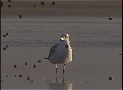

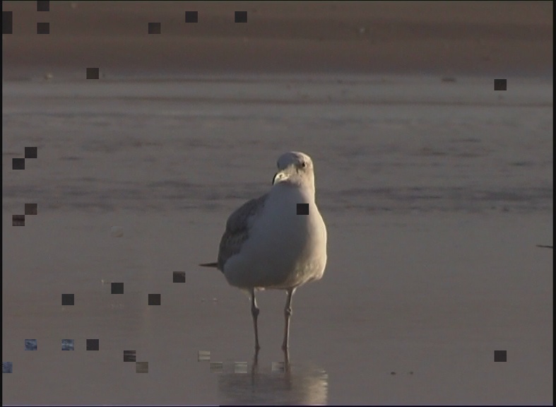

A few weeks ago I had a message "Insert cleaning cassette head is dirty".
The time code was broken (started again from zero) and I got pixelation (you can see it on the attached grabs).
Sent the camera to Canon and after a week I got a reply that the camera looks OK and there is no problem with it. After I insisted on another check, I got a reply that there is a problem with the video head and it must be replaced .
And that what we did (payed for that).
After an hour of use I had that message again with pixelation and broken timecode.
Send it to canon again, this time I had a reply that there was no alternative but to change all transport unit (including video head again).
This time I was not charged.
But...you guessed right, after less than an hour of use , pixelation again!
I am sending the camera again for repair.
Meanwhile, if any of you had this phenomenon and know what really is the problem and how to deal with it, please let me know.
If any of you is or was a canon tech person it would be even better.
Sassi

that's a dirty head...happens every once in a while. Have you tried a head cleaning tape? Also, always use the same brand of tape to help avoid that.
1 other thing I do when possible (when shooting on a fresh tape) is to "pack" the tape...meaning when you first insert a new tape, fast forward it all the way to the end and than rewind it back to the beginning. This also helps to avoid head clogs.

I see the posted images are in a sandy/beach location. Any chance you are getting sand or airborne dust in the camcorder. That will play havoc with with the camcorder.

From your replies I understand that this kind of pixelation is expected when the video head is dirty, but shouldn't a cleaning cassette solve the problem?
There was nothing special with that location (I don't think sand got into the camera).
And a new head getting dirty after 15mins of use don't make logic (and that happened twice).
I heard of users getting that message after a few years of use not minutes.
Sassi
