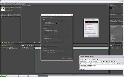

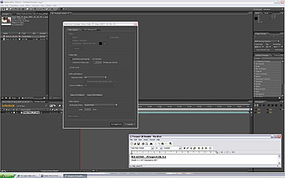

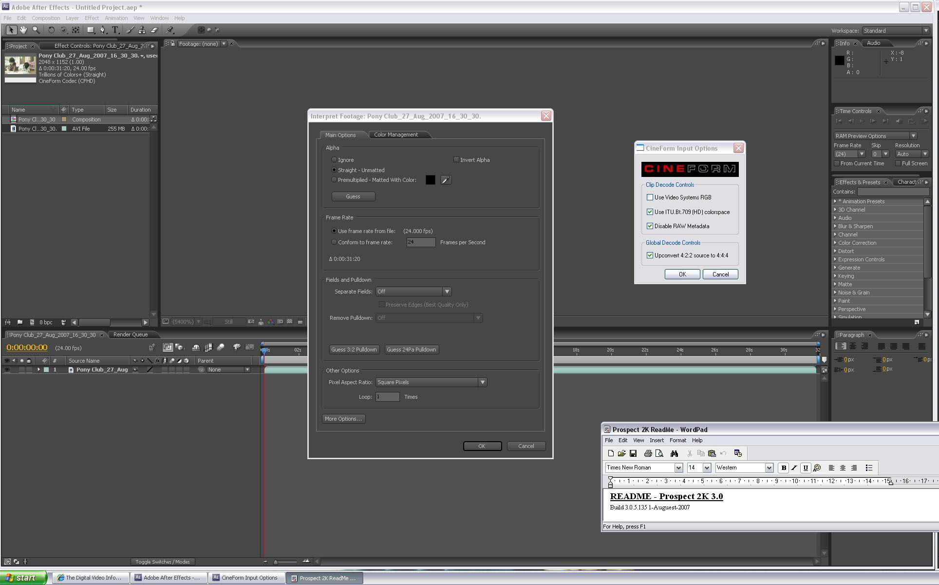

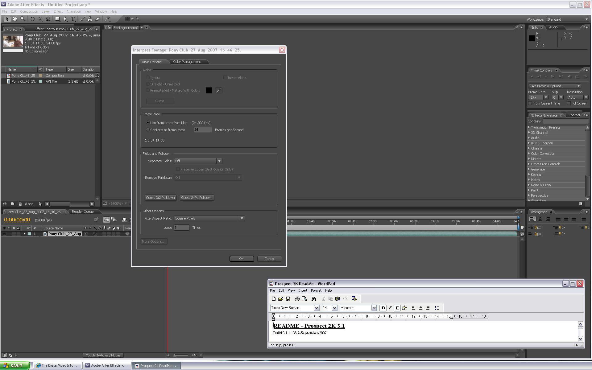

The same happens here, but only with latest Prospect 138build. It appears that AECS3 is not recognizing the Cineform Codec. When I use RAW files, the project windows is loading the file as Uncompressed AVIV too.
When I uninstal the latest version and Install build 135, After Effects is loading the clip right.
It seems that there is something missing in the new CFHD importer for AE. It can coexist with the AVI and DirectShow importers now, but you cant use the codec options, and aftereffects is not recognizing the file type.
Prospect footage in 32bit AE project-build135l.jpg   Prospect footage in 32bit AE project-build138l.jpg

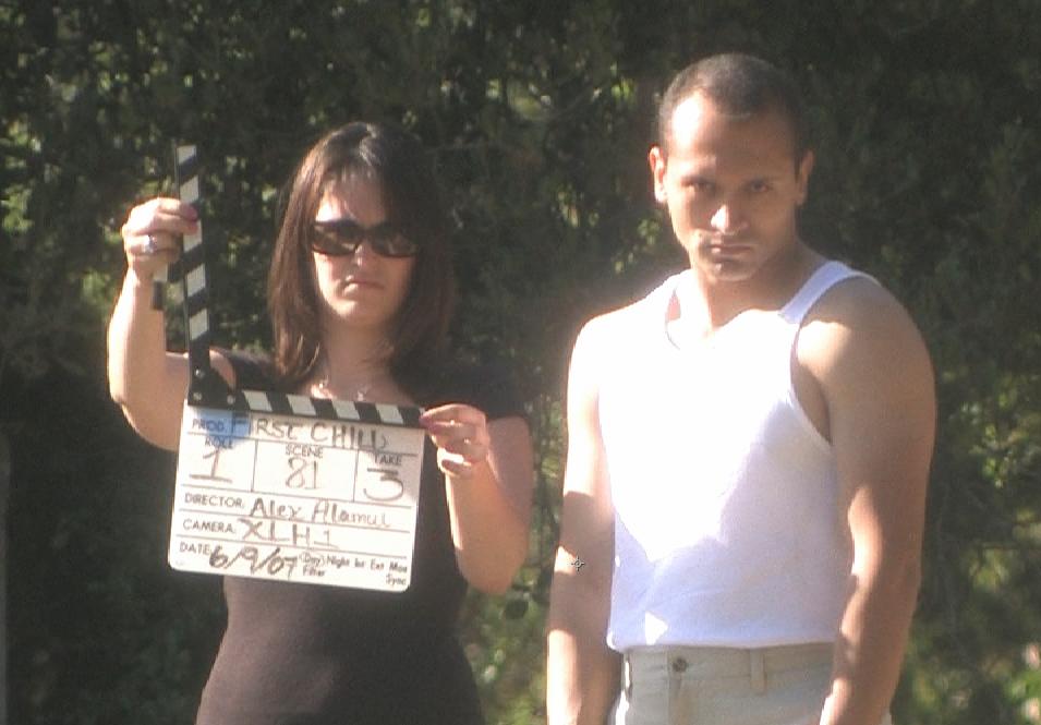

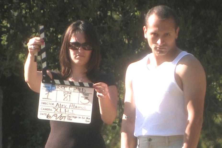

I just upgraded so the 138 build is all I've ever used. And look at the difference in picture quality: After Effects screen grab compared to Premiere.
Prospect footage in 32bit AE project-ae.jpg   Prospect footage in 32bit AE project-pr.jpg

Curious. The above just appears to be a display issue. If I render a frame to a .tiff it looks fine. Any ideas why the display should look so bad?

In Premiere you are seeing the CineForm scaler, in AE your are seeing the Adobe preview scaler (sucks doesn't it?) This is not a bug. In AE, I mostly use 50% or 100% view, not Fit, which causes the scaling unpleasantness.
