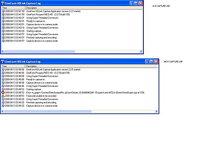

Day 3 of the Korea tests, and I have answered many of the early setup questions by researching. Still there is inconsistent captures with dropped frames. I am reinstalling Windows XP SP2 and starting from scratch. Meanwhile can anyone explain this error? I get it every time I capture HDMI from the Sony V1U live.
Error: m_graph->ConnetDirect(outputPin, pDownStream,0) (0x8004d248-IDispatch error#72) in (Direct ShowGraph.cpp at 378)
Timecode unable to be recorded

Need more of your log output. That is saying the DirectShow pins can't connect, the previous two lines will likely tell us which pins wouldn't connect.

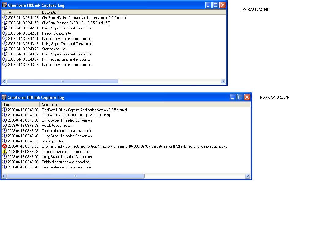

Ok so I reinstalled XP2and the latest driver for Intensity, and reinstalled Neo. As per your recommedation on the Cineform site, I powered the V1u on and attached the HDMI cable before booting up computer. I still had same problem that the video did not feed in unless I reseated the HDMI cable while Neo was running, then I got signal to the preview monitor.
As in my earlier post the quicktime movie would only playback at 12-15 frames per second from a SATA2 drive that reached speeds of 98mb on Blackmmagic's drive test. Frustrated, I just decided to select AVI conversion and do a test. Surprisingly,the AVI was perfect. It played in QT player at full frame rate. Also, attached are the error logs from both the QT test and the AVI test captures. You will see on the QT error log the "pin" error, but the previous two lines don't seem to indicate anything.

Abraham, we'll take a look at MOV capture after NAB. The temporary workaround would be to capture AVI files then re-wrap to MOV. using HD Link. Re-wrapping does not touch the underlying compression - it only replaces the wrapper on top so it's very fast.
Although the AVI files play fine in QT Player and FCP, they are only interpreted as 8 bits instead of 10. When you rewrap them to MOV then they are properly interpreted as 10 bits in Mac.

Sorry, alot going on, forgot to tell you that even with the .mov capture error in the log, the actual QT mov captures are fine; no dropped frames, all good.
