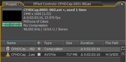

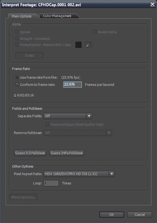

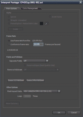

Attached are screenshots with clip properties.

The "No compression" line tells me you are not using a CineForm importer, rather you are using a Video for Windows or Directshow engine -- not good for AE.
