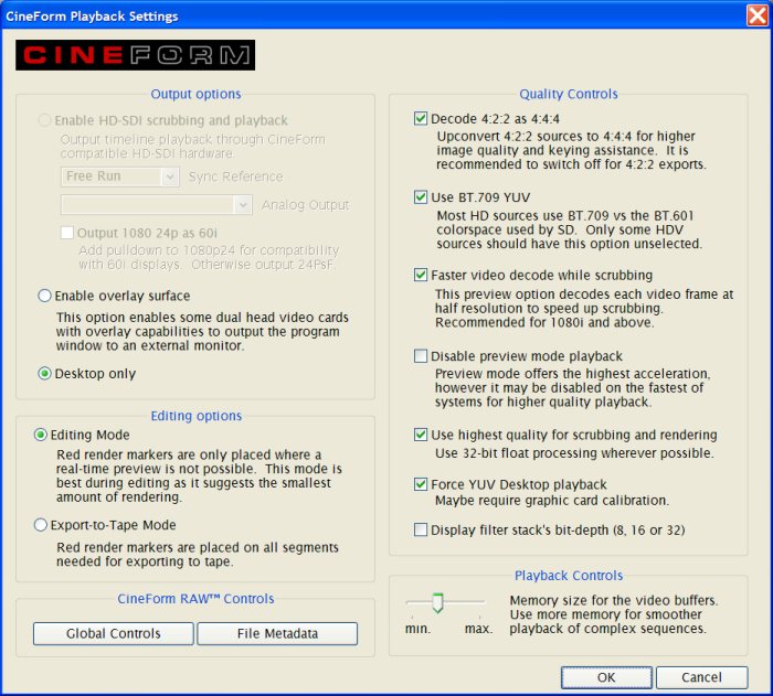

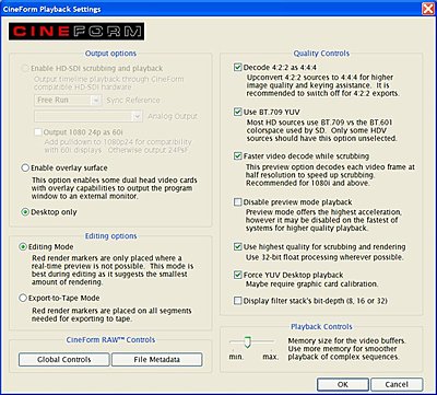

You seem to be missing a huge slice of the workflow. Here is how to add or change the look data for a particular file.
1) Place the clip in a Premiere Pro sequence using Prospect 4K.
2) Scrub so that clip is visible in the program monitor.
3) Open Playback Settings
4) Click on File Metadata data, welcome to new found power.
5) Under "Apply Look" Preset are all the installed 3D LUT look files, you can use any, alone with controller many other image characteristics.
Just the tip of the iceberg for what is coming.

QUOTE"
"4 Click on File Metadata data, welcome to new found power."
Now I shall have to discipline myself to use this absolute power responsibly.
