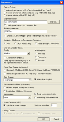

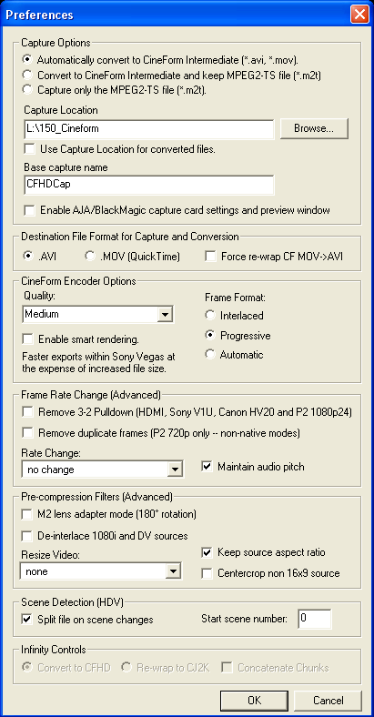

I attached a picture of my Preferences in HDLink.
Btw, i am using Win XP x64, could that be the problem? I will probably install Cineform Prospect HD on my laptop tonight. OS on my laptop is Vista Ultimate 64-bit.

Audio in Media Player when playing MTS files directly? This is the key. Frame rate issues are likely due to your AVCHD video decoder. Once you can play you source with out issue, it will convert correction. So you need to contact support.
