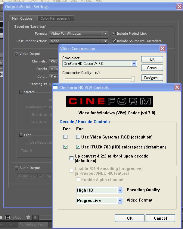

Neo Scene & After Effects CS4

CTO, CineForm Inc.
Join Date: Jul 2003
Posts: 8,095
Under the Output Module, Video for Window Format, you will find the "CineForm HD Codec V4.7.x".
