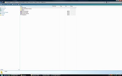

Originally Posted by Matt Vanecek View Post
I don't have the Exporter PRM in mine, on Windows Vista 64. Just did a fresh uninstall of 4.0.0 and install of 4.0.1. The CF installer does not appear to be working correctly on Vista 64, if David's screenshot is on XP.
Matt
Matt, read the previous post. This is not an XP/Vista issue, it is a PHD installer issue that was just fixed moments ago.

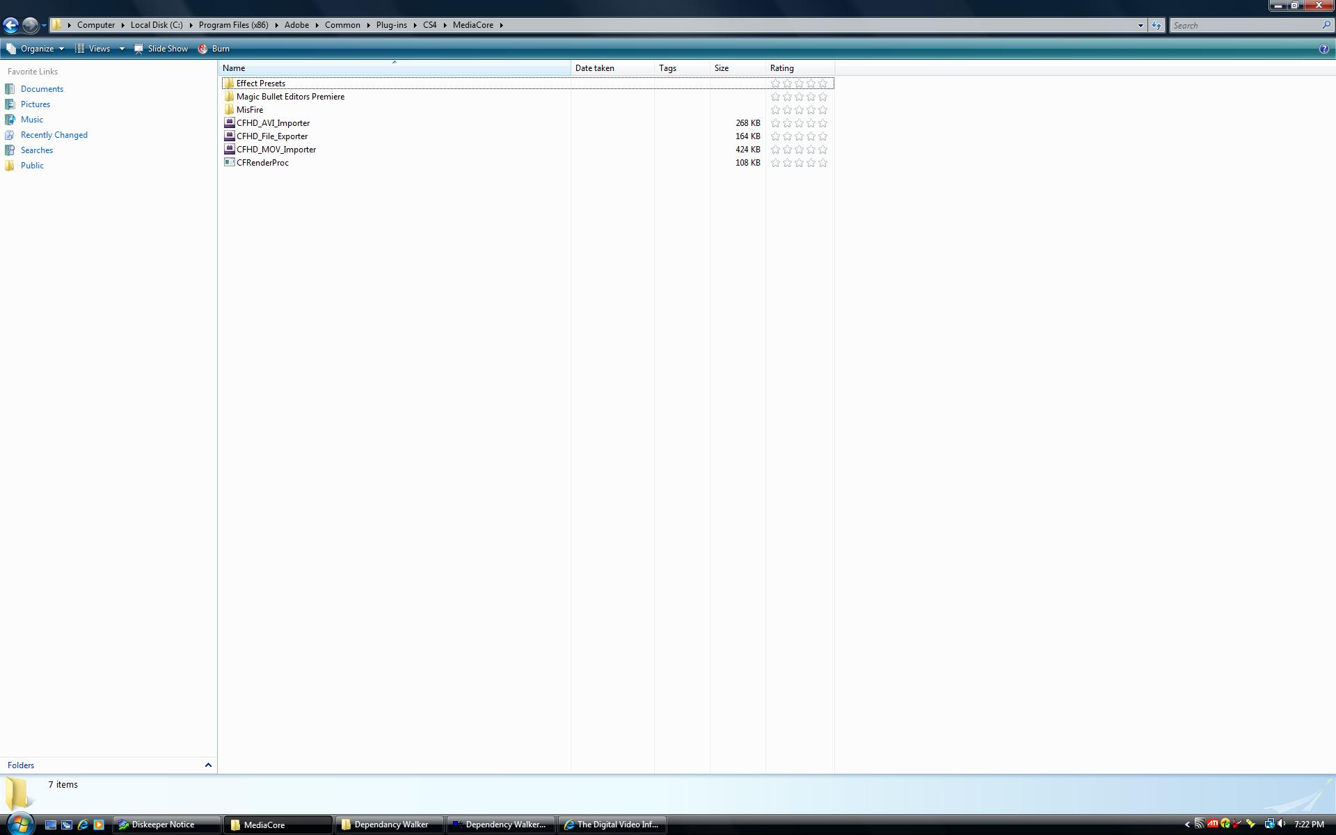

David,
I removed the initial "last beta" version and replaced with the new "last beta" version. I still cannot open First Light.
Description:
Stopped working
Problem signature:
Problem Event Name: CLR20r3
Problem Signature 01: firstlight.exe
Problem Signature 02: 0.0.0.0
Problem Signature 03: 49fb78fc
Problem Signature 04: PresentationFramework
Problem Signature 05: 3.0.0.0
Problem Signature 06: 48fef62a
Problem Signature 07: 625a
Problem Signature 08: e1
Problem Signature 09: System.Windows.Markup.XamlParse
OS Version: 6.0.6001.2.1.0.256.1
Locale ID: 1033
According to Dependency Walker
Warning: At least one delay-load dependency module was not found.
Warning: At least one module has an unresolved import due to a missing export function in a delay-load dependent module.
Error opening file IESHIMS.DLL - The system cannot find the specified file.
Also, see attched.
Tim Bickford
Tim Bickford is offline   Reply With Quote
