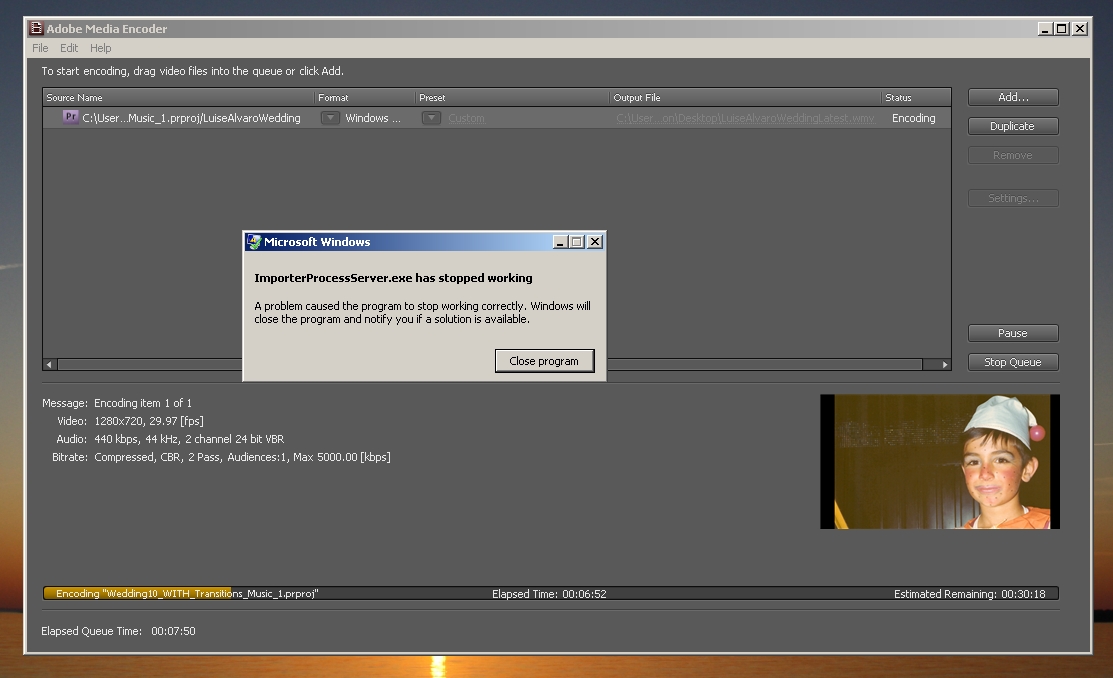

ImporterProcessServer.exe error:
Hello,
Not sure if I should do a support ticket or just mention the error here.
I installed the latest beta for Prospect HD yesterday.
My setup is:
Vista Business 64-bit
12GB
2 Xeon Quad Cores
Nvidia Quadro NVS 295
Premiere Pro CS4
After Effects CS4
I am getting the importerprocessserver.exe error via Adobe Media Encoder.
Using the settings 720p for window media player.
Any ideas?
The previous beta version worked fine with exporting. The latest has given me the error attached.
I uninstalled the latest version of Prospect HD and reinstalled the previous beta version but that does not work anymore either. I am getting the same error when I export.
Any way to remove all files of cineform and reinstall the beta version that worked for me?
Simon
Simon Zimmer is offline   Reply With Quote

I've been testing quite a bit, and have successfully converted a number of files to CineForm, adjusted them in FirstLight, and put them into a PPro CS4 project. However, I am seeing the following issues:
- Import Process Server crashes. Happens in PPro, AME, etc.
- Cannot open a project that contains After Effects linked clips, causes AE crash. AE does open standalone.
Here's a crash report from Import Process Server:

I am getting the exact same error. I also get it after a few scrubs on the timeline.
