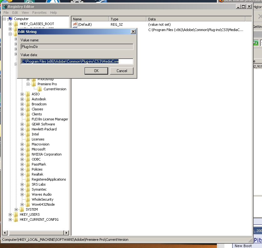

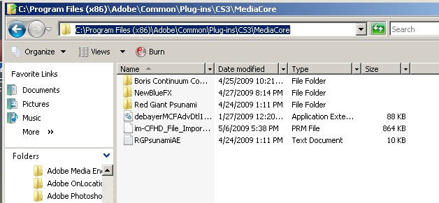

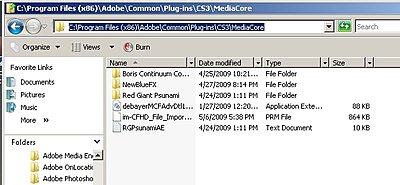

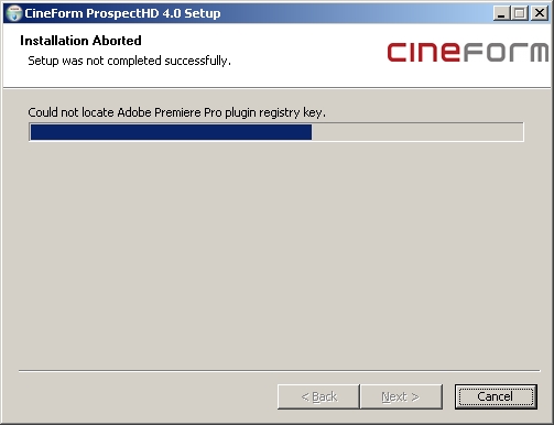

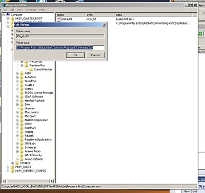

Could not locate Adobe Premiere Pro plugin registry key.
Just not having much luck today.
So I had the bright idea to uninstall Production Premium CS3 from my machine thinking it might be conflicting with my CS4 programs. Then I downloaded and tried to install the latest beta version of Prospect HD and now I get the missing Adobe Premiere Pro plugin registry key error.
I did a search of this forum and tried to fix it with David Newman's solution below:
http://www.dvinfo.net/conf/cineform-...aspect-hd.html
But no luck. Still get the same error.
I attached some screenshots. MAybe someone has an idea?
What if I reinstall PPCS4 and AECS4?
Should I install CS3 again?
Should I do a support ticket?
Simon
New Mac and PC builds posted (5/8/2009)-error.jpg   New Mac and PC builds posted (5/8/2009)-fix.jpg
New Mac and PC builds posted (5/8/2009)-mypath.jpg

Reinstall of CS3
Hello,
So I reinstalled PPCS3 and that solved the not registry key found.
But now I noticed when I installed the latest Prospect HD, it installs it in PPCS3 and not PPCS4.
What should I do?
Simon
