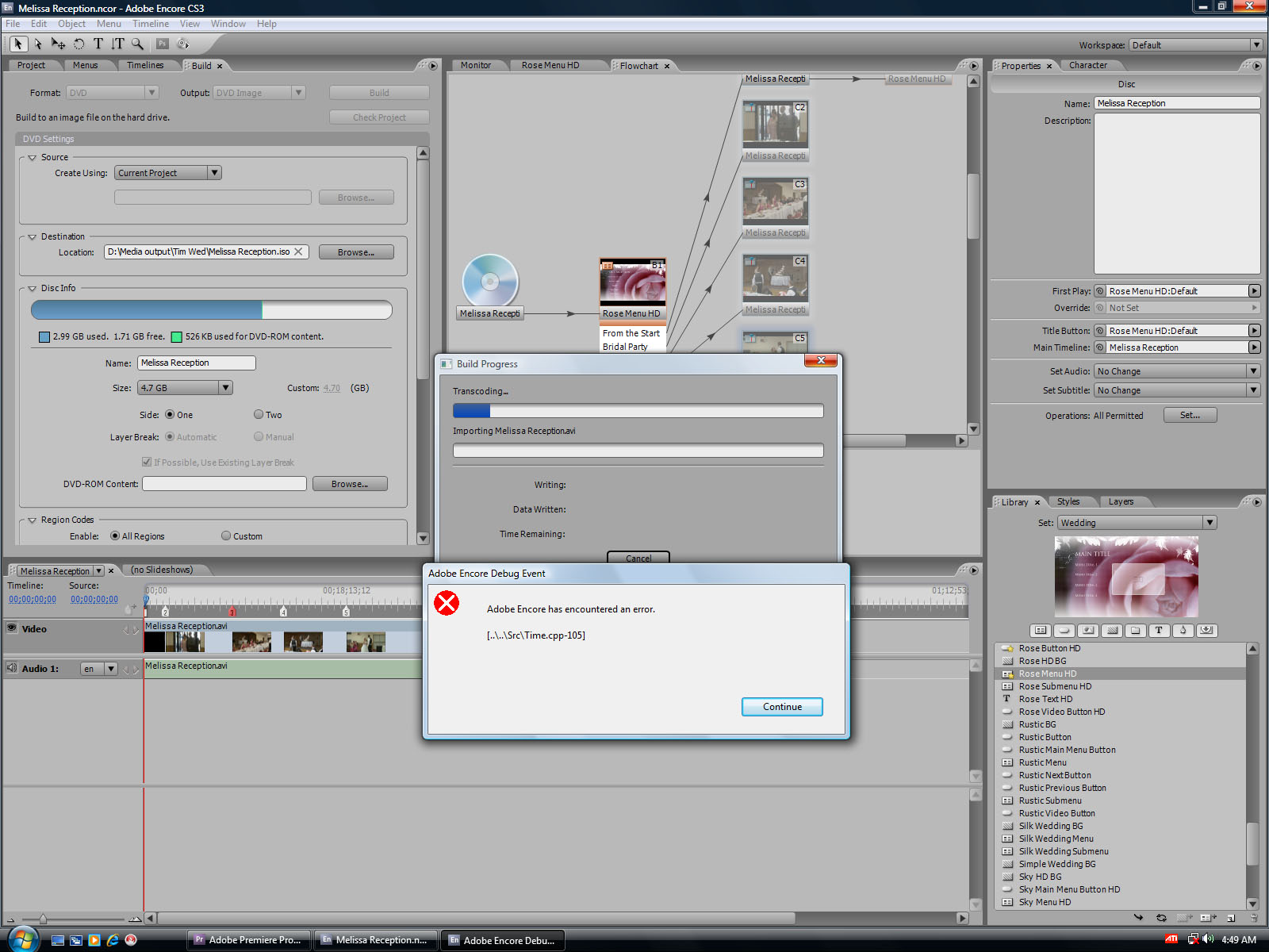

Old May 18th, 2009, 03:01 AM   #66
Join Date: Apr 2009
Location: Lebanon, PA
Posts: 221
Originally Posted by David Newman View Post
Bruce,
I don't believe anything has changes in this area. So it is not likely a new bug, particularly as SD is not a big focus for CineForm. As long as all the pixel data is there, the intepret footage is lossless, so it is a cosmetic bug. Once we solve the CS3 installer issues, and CS4 stuff, than we might find time tweak the SD exports.
Hi Dave,
Encore crashed when trying to create DVD. Maybe the squashing has something to do with the importprocess server crashes. I did output the file no problem with v3.4.5 in CS3 and the CF.avi did not look squashed after encoding? It almost like the encoder is trying to double encode?
Prospect/Neo 4 Problem Thread-encore-crash.jpg
Bruce Gruber is offline   Reply With Quote

Old May 18th, 2009, 10:18 AM   #69
Join Date: Apr 2009
Posts: 221
Follow up to Encore crash
Dave,
Encore CS3 crashed on the squashed file as you can see by my post but..Encore CS4 transcoded fine all the ay thru at 4:3 (I fogot to click 16x9) in the transcoder button when I went to transcode 16x9 after I selected interept footage Encore CS4 crahsed too.
could there be something with the wide/ntsc setting and the importprocess error? Dave when I was trying the 3.4.9 version of CF this never occured and even media player saw the CF.avi as a 16x9 output on the exact same computer?
