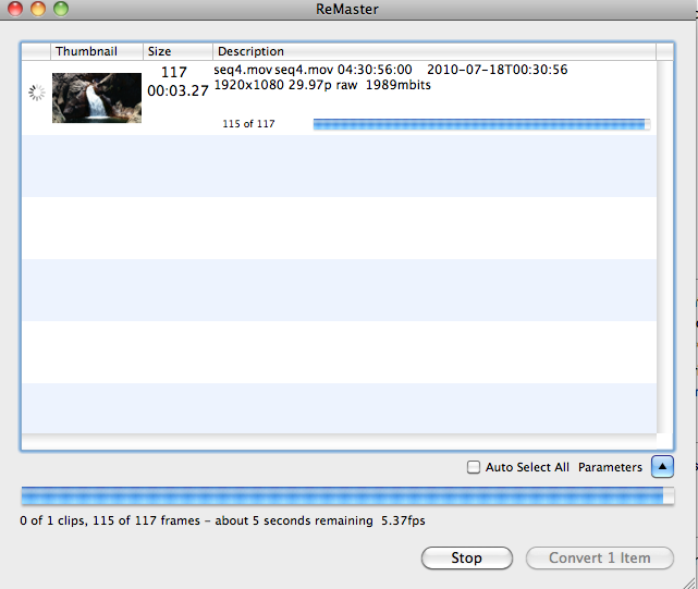

OK. this is officially making me crazy. If I create a loop file that is 150 frames, it craps out at 147. if I create a file that is 210 frames, it craps out at 198. No matter what I do, it doesn't complete the remaster. If I've tried importing HDV, uncompressed 10 bit quicktime, and it does not matter.

And it even happens when I use a codec like Apple Intermediate Codec as the source. It keeps freezing at the same frame too - now it's frame 286 out of 300. How can this be? It's a completely re-encoded source file and bitrates are TOTALLY different.

Well, whatever it was, the newest update fixed it.
Whew. /wipes brow.
