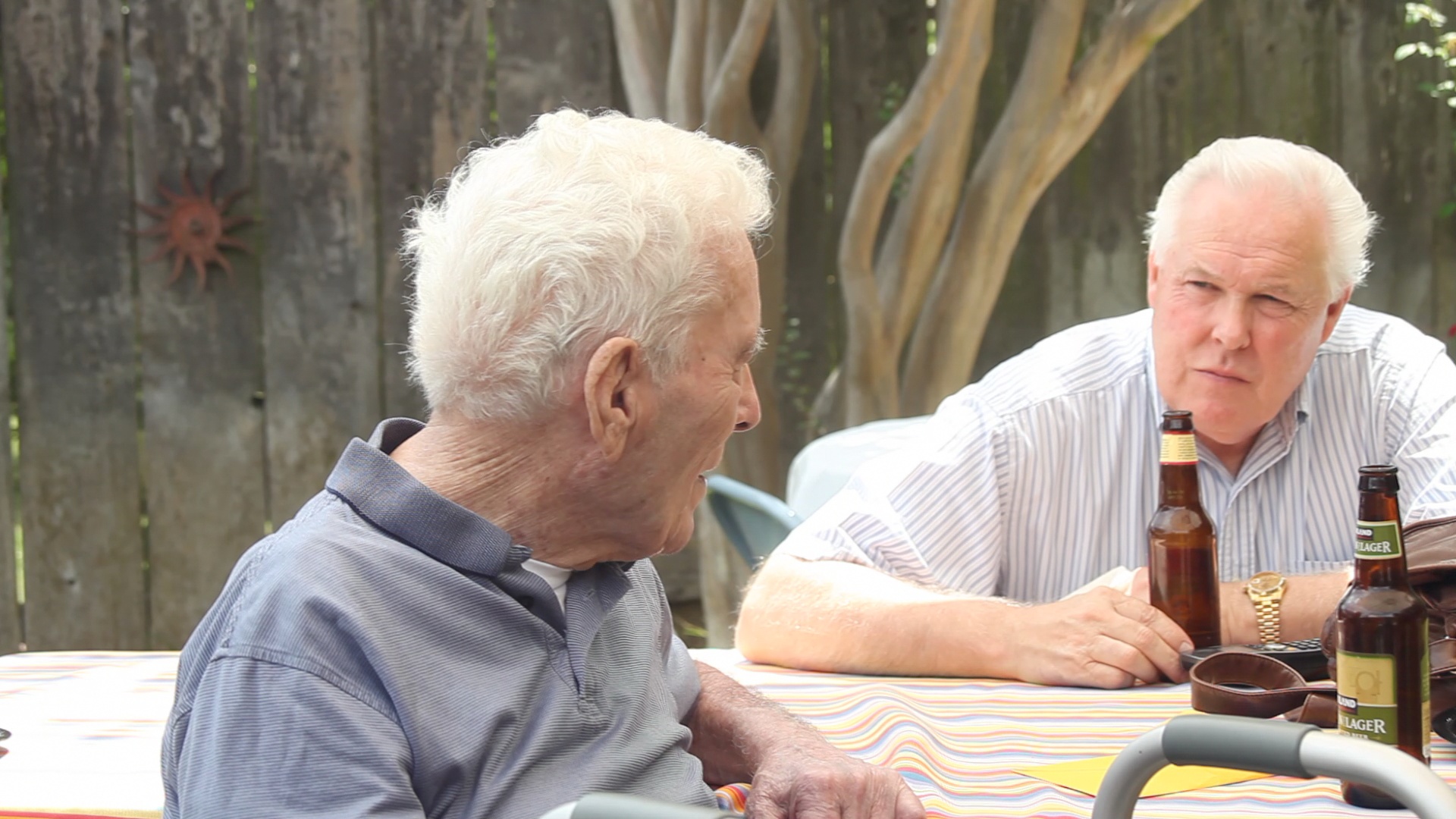

Example
Here are two grabs, one from cineform, and one right from original clip. Check out shirt under chin of man in foreground.
I am not converting at highest level from NeoScene, perhaps that is keep the moire down ?
(now edited with proper grabs)

I think the default decoders Quickime is using has edge enhancement (bad.) Look at the dark outlines around the white text on the bottle label. You can add edge enhancement, but you can't remove it, so we don't do that. I think that is what you are seeing.
