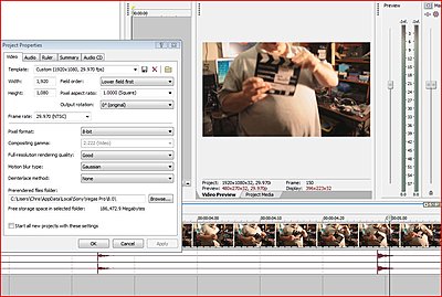

In fact, it is off at beginning of my clip (5 secoonds in) with cursor passing clap sound almost 2 frames ahead of video... mic about 4 feet away.

Phew, glad it's not just me!
Chris, can you check 2 other things for me:
1) compare the Cineform clip to the source and tell me if the Cineform clip has the first few frames (maybe 5-10) of either the lead or tail clipped off? Not that they are important, just curious.
2) tell me how many frames out of synch the avi audio is from the source mov audio at the 5 minuteish point? I just want to see if it is the same as mine so I can tell if I'm doing anything else wrong. :)

There is no doubt they will be out of synch. This is because the original is running at 30 fps, and the Cineform has been conformed or retimed to 29.97 fps. Cineform made the decision to do this based on its belief that the editing files should conform to 29.97 fps. There was and may still be some dispute as to what frame rate the camera actually records.
You need to upgraded to firmware 1.10 from Canon. In manual mode you have absolute control of shutter speed, aperature, and ISO ! Just be sure camera is set up in LiveView, Movies and Stills, and set in Movie mode under the subsetting there. If you don't do that, it will still act like it is in auto.
Edit: I checked frames at begining of clip, and everything seemed to be in line at beginning of both clips... Frames identical in initial frames. then I realigned everything to make the ends match up, checking frames again. Though I couldn't get an exact matchup at end, they had same last frames..
Check the audio tracks of both the original MOV and CFHD AVI files for a clip that has sound all the way to the end, on a Vegas 29.97 timeline. Do the tail ends of the audio waveforms look the same to you? Don't stretch the original MOV file to match the AVI. Just look at the tail ends. You might have to zoom in on the timeline a lot.
Mine don't match up in any way.
