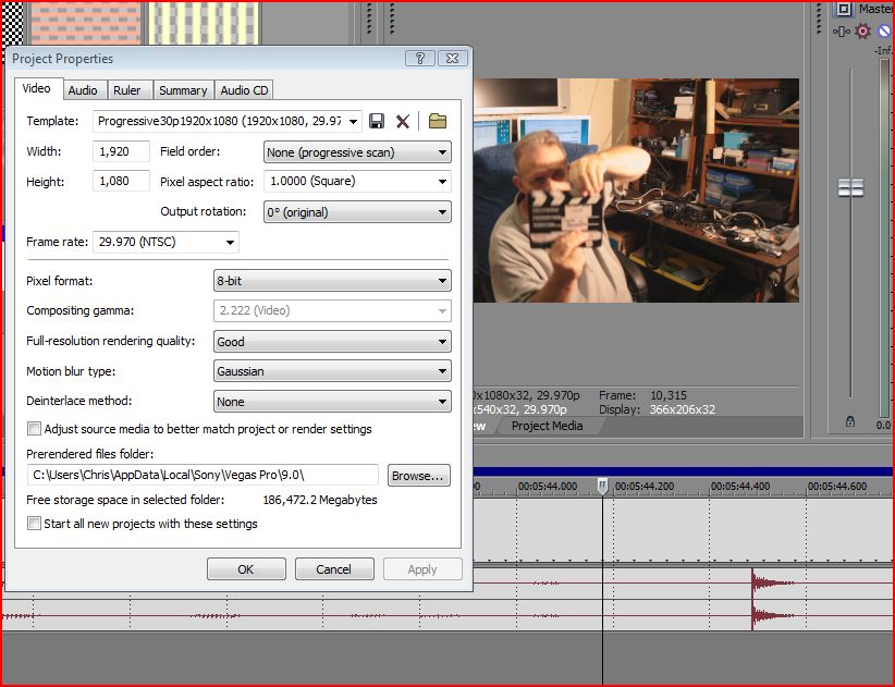

David:
Dylan is right. We are not synching again. I am about 9 frames off at 5:44 of a six minute or so clip. At least in Vegas 9.
The attached Snipping of the time line show how project is set up. The time indicator is at point of clapper coming together. Note the sound is nine frames down about. I assume those are frame ticks.
Edit: After posting, I checked in at Vegas 8, same issues there.
